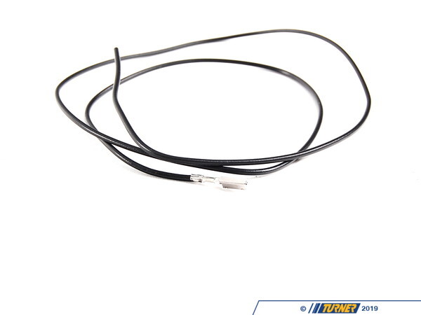

    • 2 Pre Crimped terminals/wire leads (BMW P/N 61130005197)

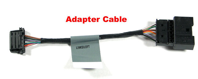

    Begin with your two adapter cables. They are labelled left/right.
    Click image for larger version  Name:	50724212743_7c302601f0_z.jpg Views:	87 Size:	24.5 KB ID:	73551

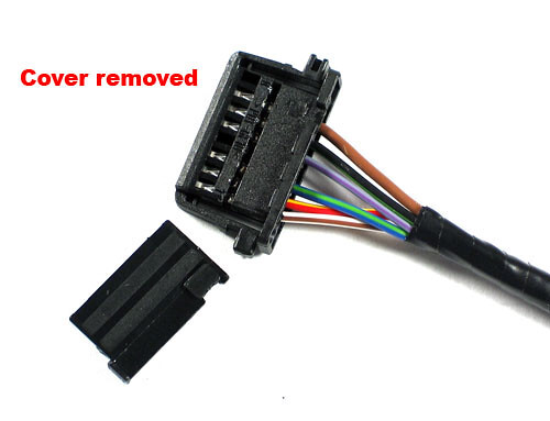

    Remove the cover on the end of the adapter that plugs into the taillights. Tiger Dave says this is optional, but I found it necessary to insert the new wire, YMMV.
    Click image for larger version  Name:	50724212723_691b2652a7.jpg".jpg Views:	87 Size:	38.8 KB ID:	73552

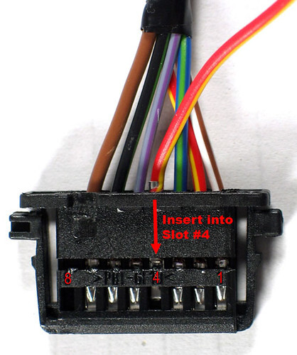

    The Connectors are labelled slots 1 through 8, and slot number 4 is empty. This is the slot we will need to trigger the outer LEDs.
    Click image for larger version  Name:	50725036417_5c3e6bd907.jpg".jpg Views:	87 Size:	27.2 KB ID:	73553

    Insert the other end of your new wire into slot #4 of the taillight connector.

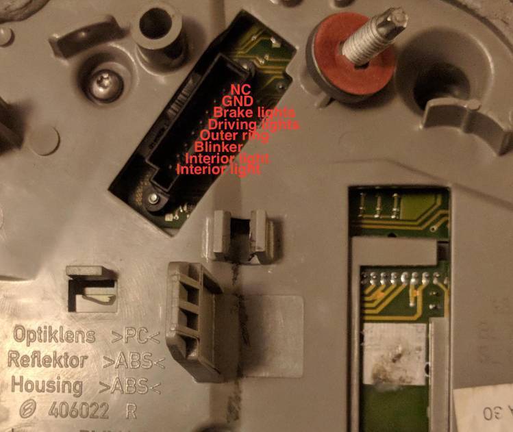

            Basically the same exact thing needs to be done for facelift cars. Here's the pinout for the taillights.

            Facelift cars should have a wire running to the outer ring pin, unlike the prefacelift cars where that pin is blank in the connector. I would just pull that wire out of the connector, add some heat shrink tubing around the pin so it doesn't short against things, and then just follow the instructions in the OP.

                  Outer ring wire goes to the LCM for the brake force display. LCM triggers the outer ring under hard braking (I forget if that's something that needs to be coded in or is enabled by default). I wouldn't want to raise this line to 12V without the LCM knowing about it because I'm not sure if there's any short protection on the LCM output, so it's just safer to disconnect the existing wire all together. Here's the steps I would take to get this working on a facelift car:
                  1. Disassemble the connector and remove the wire going to the outer ring pin.
                  2. Put heat shrink tubing on the end of it to avoid having it short out against things.
                  3. Get you new pre-pinned wire (61130005197) and insert it into the slot where the outer ring wire used to be.
                  4. Tap/solder the new wire into the wire going to the brake lights pin so that the outer ring and brake lights pin are now electrically connected.
                  5. Make it pretty and put it back together.
                  I avoided using pin numbers because I'm not sure if the slot numbers on the stock facelift harness match the slot numbers on the retrofit harness (the one in the OP). So just reference the image I posted to know which pin/wire is doing what.
