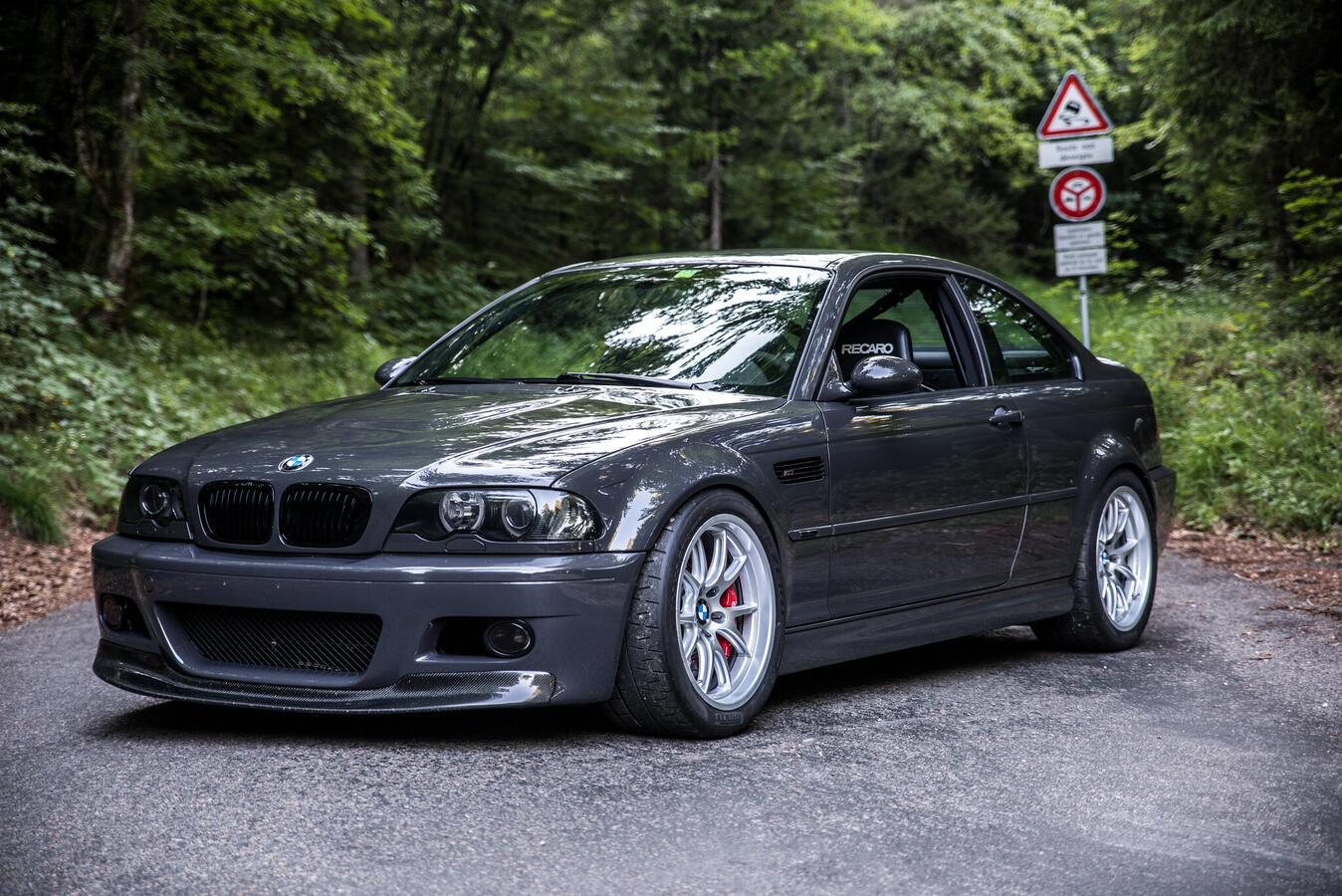

      I run a square setup and love it. You do give up some steering feel, but I like the extra engagement required to correct tram-lining and the turn-in is fantastic. I also like how the car looks because I take advantage of the factory wide body. Idk if I would feel the same on a daily driver, but I love having an aggressive alignment on my "spirited driving" car.

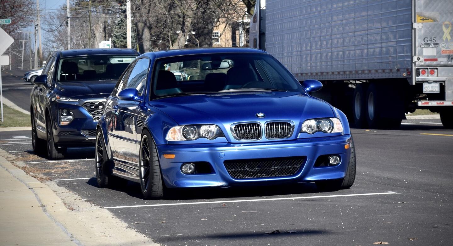

                I have a staggered street set up and a square track set up. Sometimes I run spacers in the back of the square set up to get rid of that ugly wheel gap. Even at the track I don't rub much and don't feel a difference with the spacers on. it's only 10mm (iirc) and I have extended studs so I'm not worried about them.
                Square 18x10 +25 with a spacer in the back:
