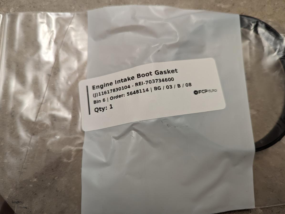

                      I was looking through some pictures of when I did my eventuri install a couple years ago. I recall something about this too. For some reason, I took a picture at the time of something I had to order from fcpeuro for my install- part # 11617830104​ (#9) on the realoem diagram posted earlier. I took a picture of that part for some reason - maybe it was for this! Hope it helps - not sure.

                        Thanks for the reply, nope its not that part. This rubber ring is more like a stretchy rubber band and is much bigger. It definitely came out when when i took apart the Eventuri air filter.

                              Did you have difficulty fully seating the MAF housing into the factory elbow with this new gasket? I just installed mine a few days ago and replaced that gasket and was able to get it but was definitely a far tighter fit. Took some rocking back and forth to get it to seat.
