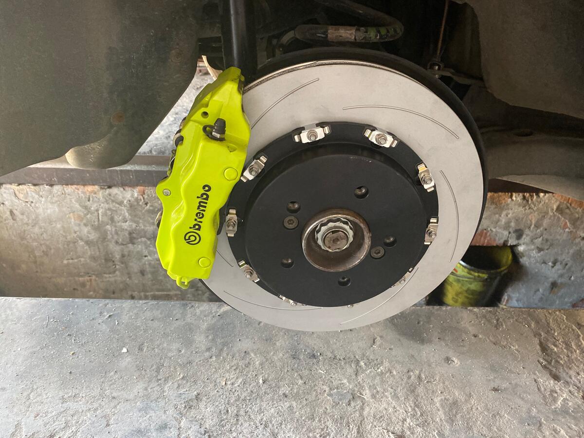

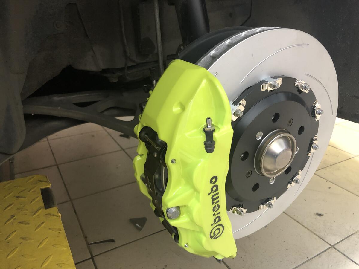

                  I use front calipers from Alfa Gulia quadrofolio, with 355/32 rotors, and rear from porshe with 345/24 rotors, works absolutely perfect
                    Pnvhome - Believe I read the front calipers are 34 and 38mm pistons, can you confirm this and is it two 34mm and one 38mm or a different combination?
                    Where did you get the front brake discs, are they custom?
                    Thanks
                      Thanks
                      According documentation it is - 6 Pistons of : 38 - 34 - 30, disks are custom from brembo and some handmade, pads are hawk, and also additional custom fastenings, also a little problem in design even apex ec7r (18) need 5mm spacers to fit ok)
                      In any case, these brakes are quietly enough to brake from 250 km / h without severe overheating, the stock brakes died already by 150 km / h when decelerating from 250. And price for that about 3800$ for front and rear.

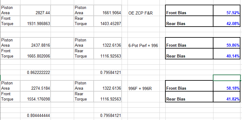

                          I have made my own calculator to compare different setups. I think you can start from here, there are multiple factors not accounted but it would serve as a baseline to compare different setups all else equal. I can send you the file in an email, as it gave me an error here.
                          One thing I have always wondered about is why no one has ever pointed that from a pure brake torque perspective, the OE ZCP callipers provide more clamping force than the Porsche setup. in fact, not even the DB9 callipers with 40/44 pistons would provide the same clamping force as the 60mm floater. The newer option (Renault Megane callipers) with 2 40mm pistons would be better than the Porsche's, but nowhere near the OE ZCP. Food for thought I guess
                          This was also part of the reasoning behind my calliper selection (135i + 996). which is better than a pure 996 setup from a clamping force perspective.
                            Does clamping even matter? I haven’t heard anyone say they can’t push hard enough to engage ABS with any brake setup on these cars?
                            That’s an honest question, I’ve never considered clamping force much.
                              I think it does, why wouldn’t it? Is just as important as rotor diameter, etc. Is a factor to consider as part of the whole package. I did notice that with my setup it does take a bit more effort to trigger the ABS.
                              if you move to a larger rotor, or change to a more aggressive pad, then you can compensate for that, but if keeping OE size rotors and similar pad compound, is an important factor in my book. This was my case as I kept using Textar pads and OE rotors.
                              what I do agree 100% with everyone is the extreme improvement in brake pedal feel and consistency
