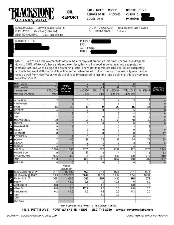

                      Most recent Blackstone oil analysis report. Looking pretty good.
                      Feff

                        Am I screwed?
                          Am I screwed?
                          At 100k, it would be time to do the bearings. I’ve noticed early bearing wear doesn’t always show up in oil trend analysis, so the fact that its showing up confirms its time.
                            +1. Definitely get it done before your crankshaft gets scored. At that point you'll be screwed.
