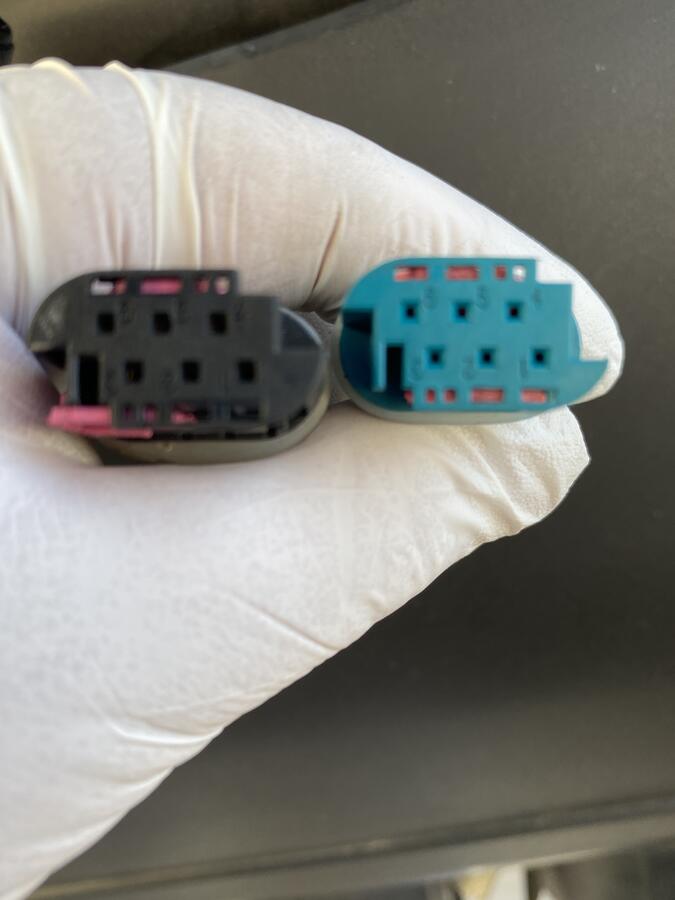

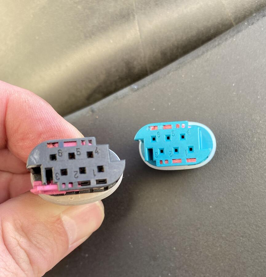

              Also it might be shadows but pretty sure the new 6 PIN “blue connector” has smaller pin holes. Which “could” keep it from rocking. These are photos I took showing this between my old (black one) vs the new (blue one).
