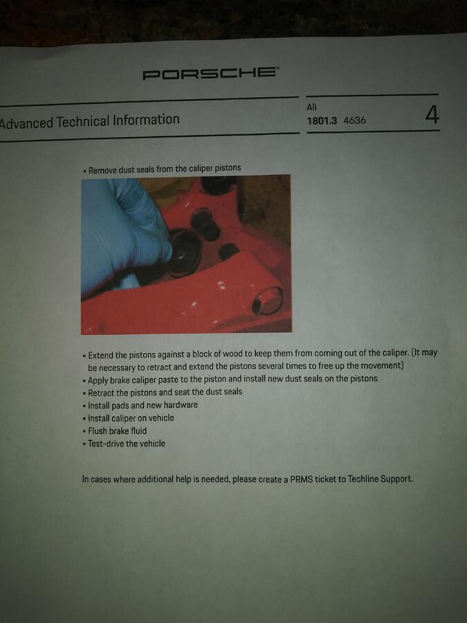

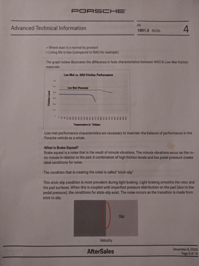

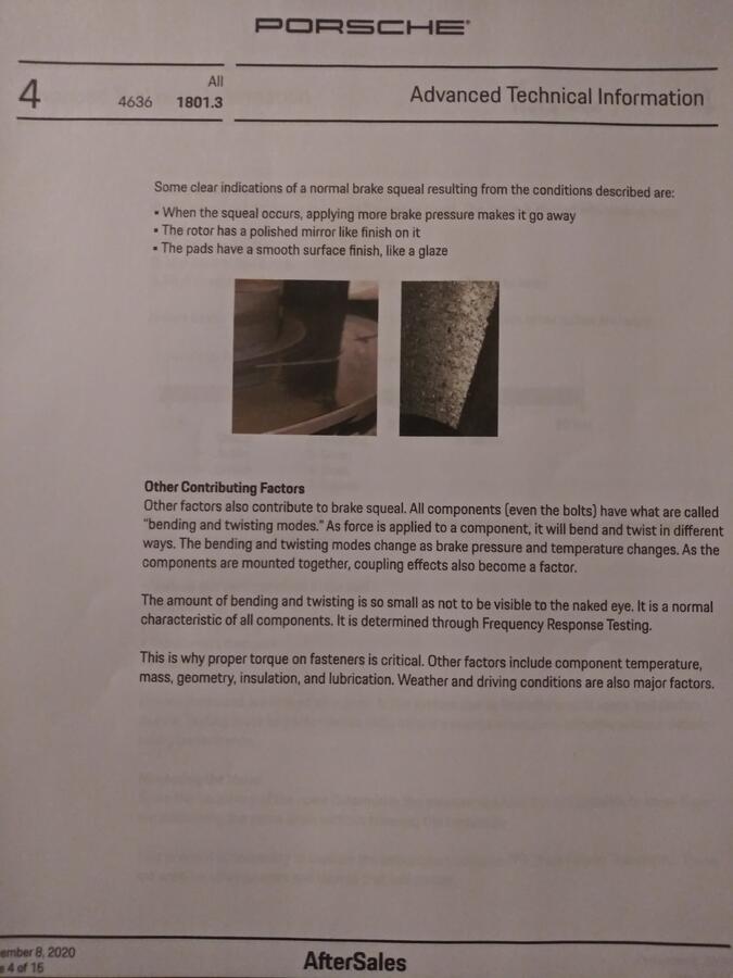

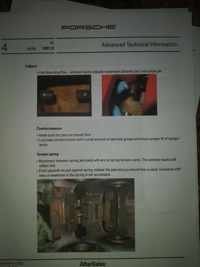

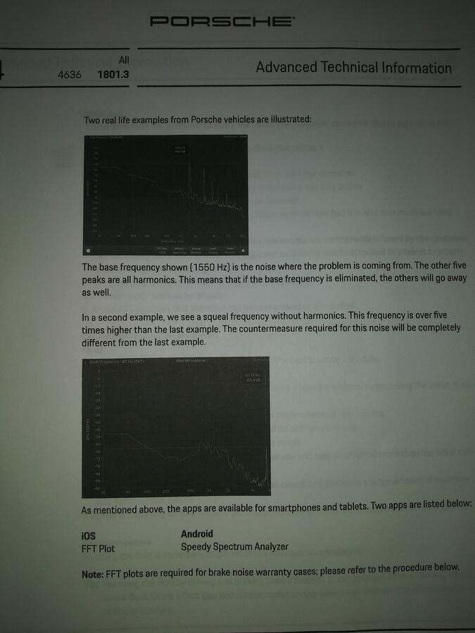

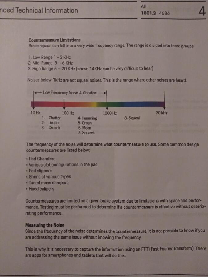

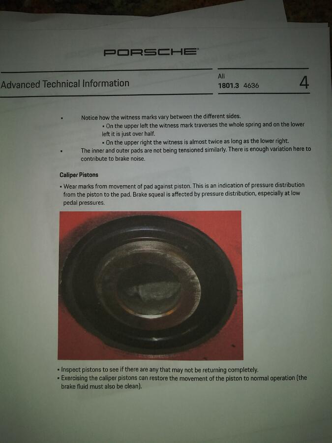

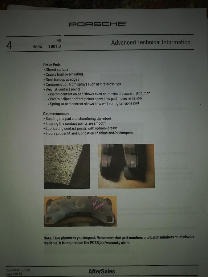

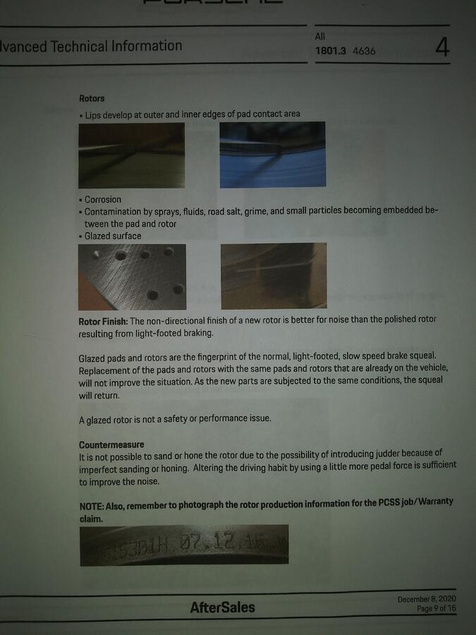

I said I would post the TI when I got the chance so here it is. I'll put the pictures in following posts
Why brakes squeal
Why brakes squeal
