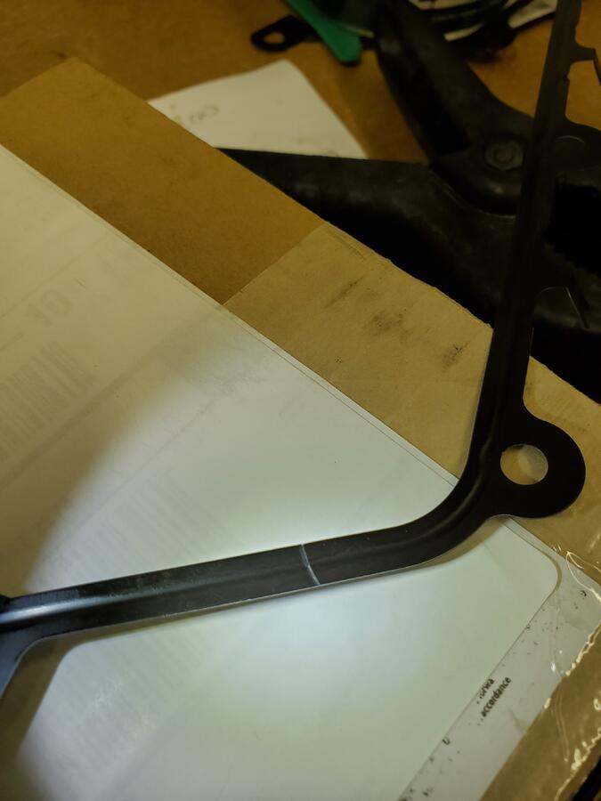

    I am trying to decide if it might be a good idea to add a bit of RTV sealant to the Vanos gasket on either side of it. Any tips?
    I've got some of the Toyota FIPG as well as Loctite 5970 RTV. My new vanos gasket has a very small nick in it so I am thinking some RTV or new gasket might have to happen.

      His is nicked. I'd get a new one unless you must drive the car now. Otherwise yeah, I would put some on there.
        Just going to play it safe and get a new one, its 30° here w/ snow anyways, no rush.
