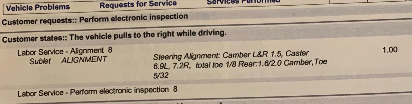

    2 - Went for an alignment after that to a reputable shop in LA (The M Shop), and the shop struggled with the caster on the front right. Obviously you can't adjust that with a stock setup so what you have is what you get. The mechanic didn't find any damaged part that could explain that and brought up the idea of a hit on the car that could do that. It did fix the pulling at fairly low speed, but not at a higher speed. For the first time though, I started feeling like on some highway segments, the pull would be to the left which lead me to wonder if the setup wasn't just overly sensitive to the road camber (tram lining I believe it's called).

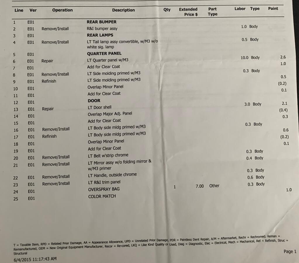

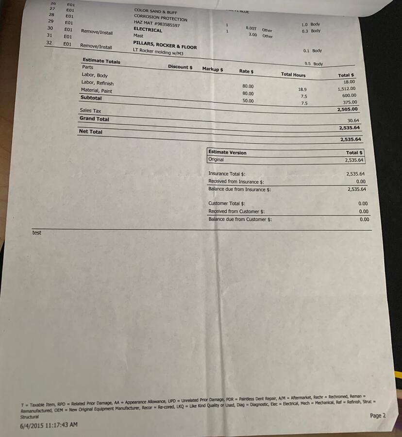

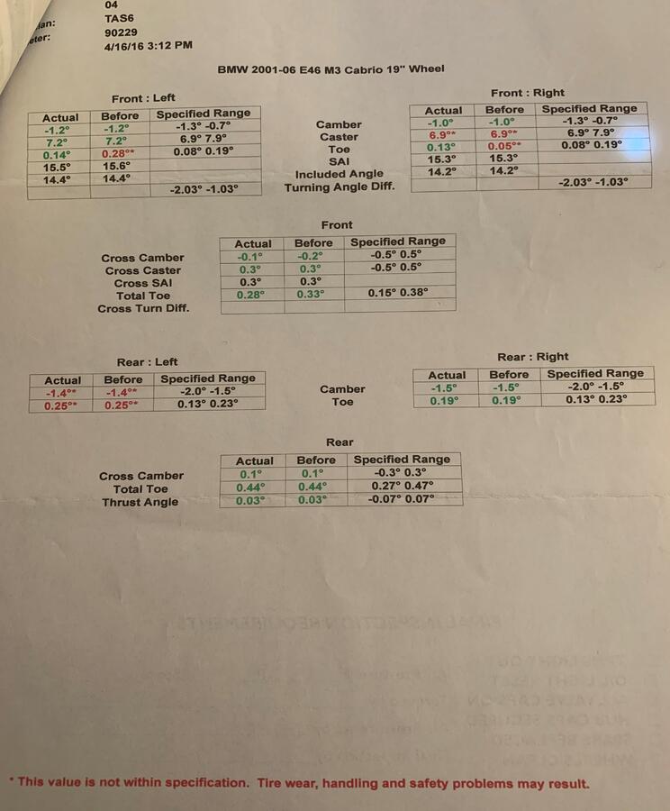

    3 - Called the previous owner (who was the first and unique owner until I bought it) to see if he forgot to say something. He told me he did encounter a fender bender and to look at the documentation he gave me - which indeed mention the work from a body shop, except that it was for the rear part of the car, not the front. He said recalling someone pulling back into the front of his car at some point over the 16 years of ownership, which he says was minor but couldn't remember much more. I also found while looking into the documentation the last alignment he did in 2016 and it showed very similar results as the work done by the M Shop.

    5 - Had the car checked by a detailing guy to bring back it's former glory, and he did notice the front right looks redone - inconsistent paintwork quality from hood to quarter-panel, guessed new front bumper and headlight. That confirmed a hit, but hard to really say what consequences it could have had/may have.

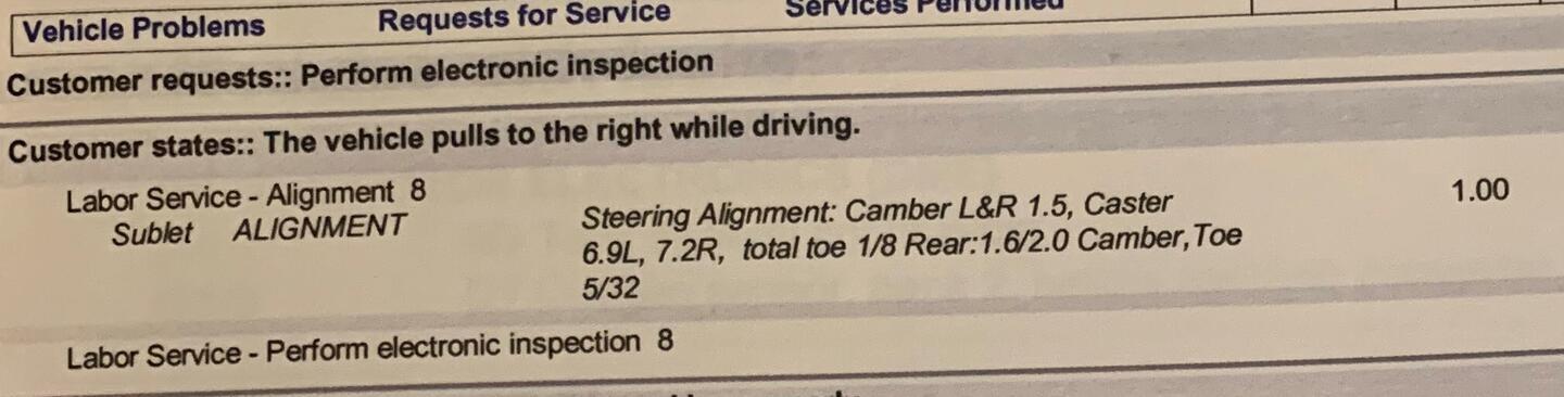

    5 - Brought the car for another alignment, this time to Bavarian Workshop in LA area. They worked on alignment to match the lowered setup and apart from the rear trailing arms being out of adjustment, they told me it was good to go. I took the car a ride and still noticed the pull to the right, but on the rare segments where the road camber is to the left, I'm pretty sure it pulls left too. I called to ask a bit of feedback and they believe the tires are most likely the reason why the car is tram lining so much.

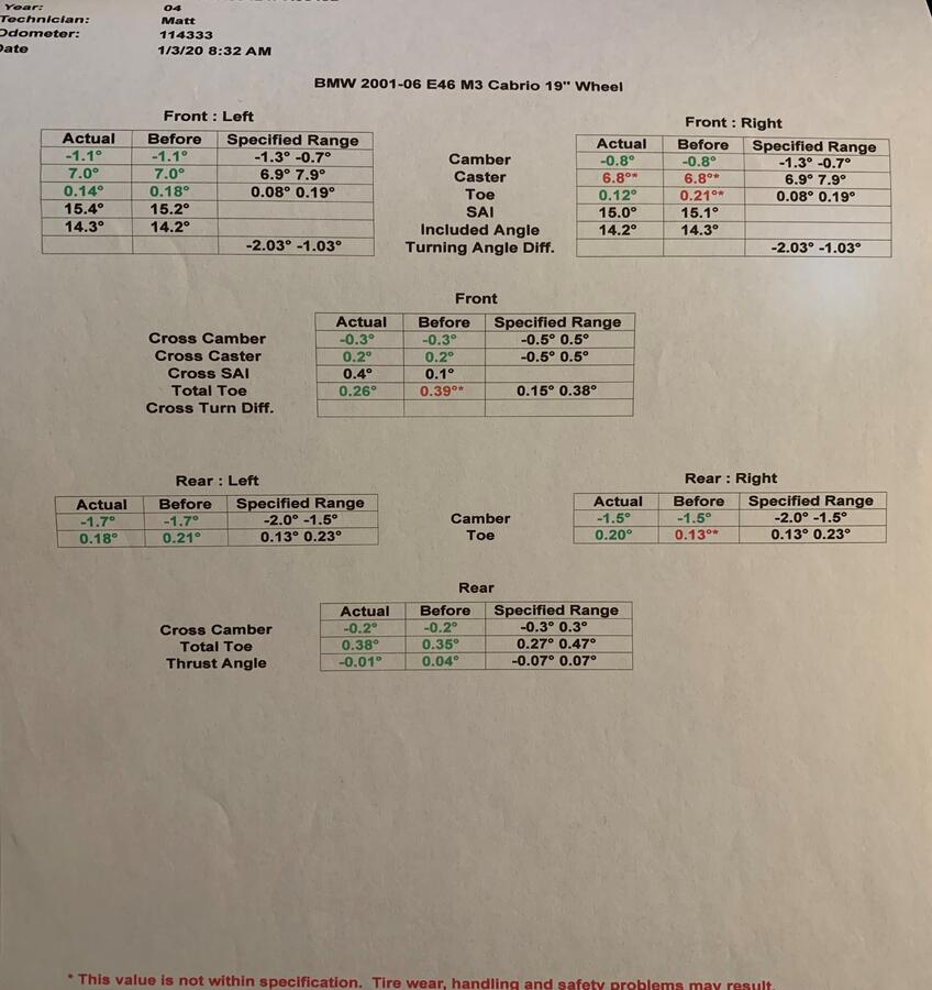

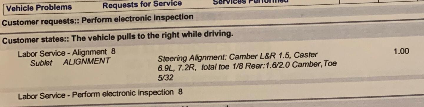

      The first paper shows caster being slightly less on the right but then the verification shows it being less on the left. Everything matches except that. You want equal caster. It will cause the car to pull. .3° isn't much but it could be a start if the paper is right. If the car was hit on the left side, I would think it would pull to the left.

        The latest and current alignment is the one below:
        Click image for larger version  Name:	image_2710.jpg Views:	0 Size:	64.4 KB ID:	26436

                    Just judging off the alignment sheet I think your issue lies in the caster.
