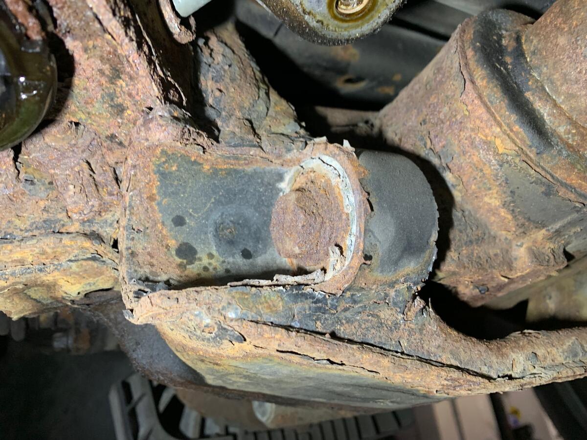

            You should see my subframe haha, I no longer winter my car since all the rust on the body itself was repaired. But my subframe is absolutely disgusting:

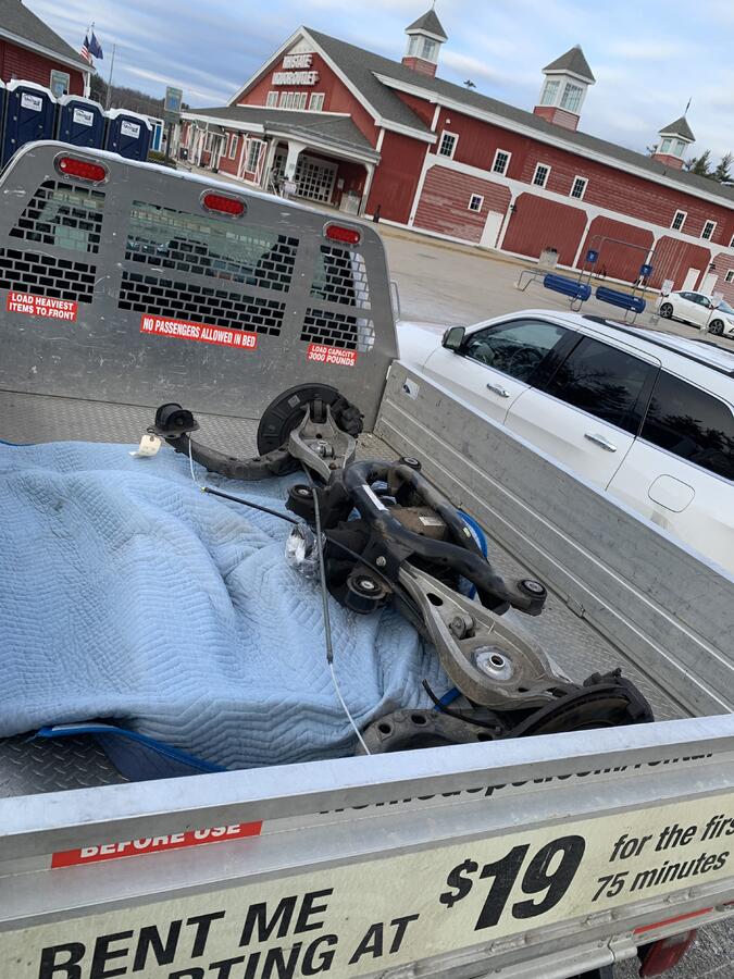

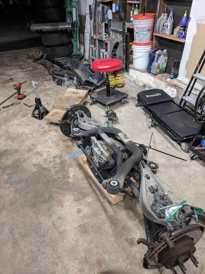

              Hah... I feel your pain! See subframe image while getting diff bushings done along with rod bearings in 2019... also attached is the new assembly I picked up.

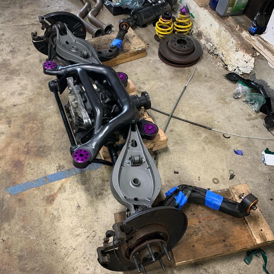

                Hey BTB, I have gone down this rabbit hole. Check out my Insta Jersey_M3 . I took some decent photos of sandblasting my entire rear end during my subframe reinforcement. I did a lot of research and decided on going with steel it spray paint. I sandblasted first, wiped all the parts down, and then sprayed on the paint. The final results came out great. Holding up well too, even in the rust belt with daily driving. Best part about the product is that if I find an issue, or rust crops up, I can just sand it down to bare metal and hit it again with more spray paint. It blends excellent. Cant do this with powder coating or paint.... as far as I know. If powder coating cracks or chips, gotta redo it.... again as far as I know. There was no interference upon install as well, bushings went right in once I figured out the right way to press them in. I went solid bushings on the subframe, RTAB bushings are Syncro Design Works, and all other bushings got replaced with OE, highly recommend this combo. I did all of this myself in my garage so if you have questions, shoot me a PM.

                  that's beautiful! Might as well just do all the underbody

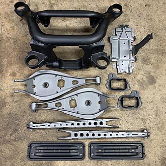

                    I powdercoated all the subframe parts that I could when I was doing my rear vincebar install. I also painted the underside of the chassis since at that point everything was looking factory fresh. I wouldn’t do it any other way now looking back at the finished product!
                    Current:
                      BMWahba that looks SEXY AF!
                        Dang...man.
