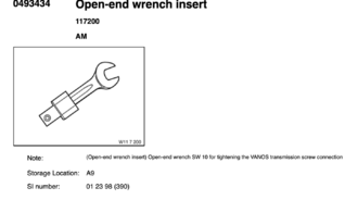

Why use a method that you can't torque the VANOS hub bolts to spec?
    Click image for larger version Name:	Screen Shot 2021-01-12 at 9.56.40 AM.png Views:	0 Size:	52.0 KB ID:	78621
    Certainly looks like a crowsfoot attachment. newTIS.info
    I think he is just pointing out the two are calibrated for each other.
      1) Tool 117200 is not a crowfoot adapter. It's an accurate digital torque wrench. BMW would not recomment to torque anything this critical using a crowfoot adapter with torque wrench.

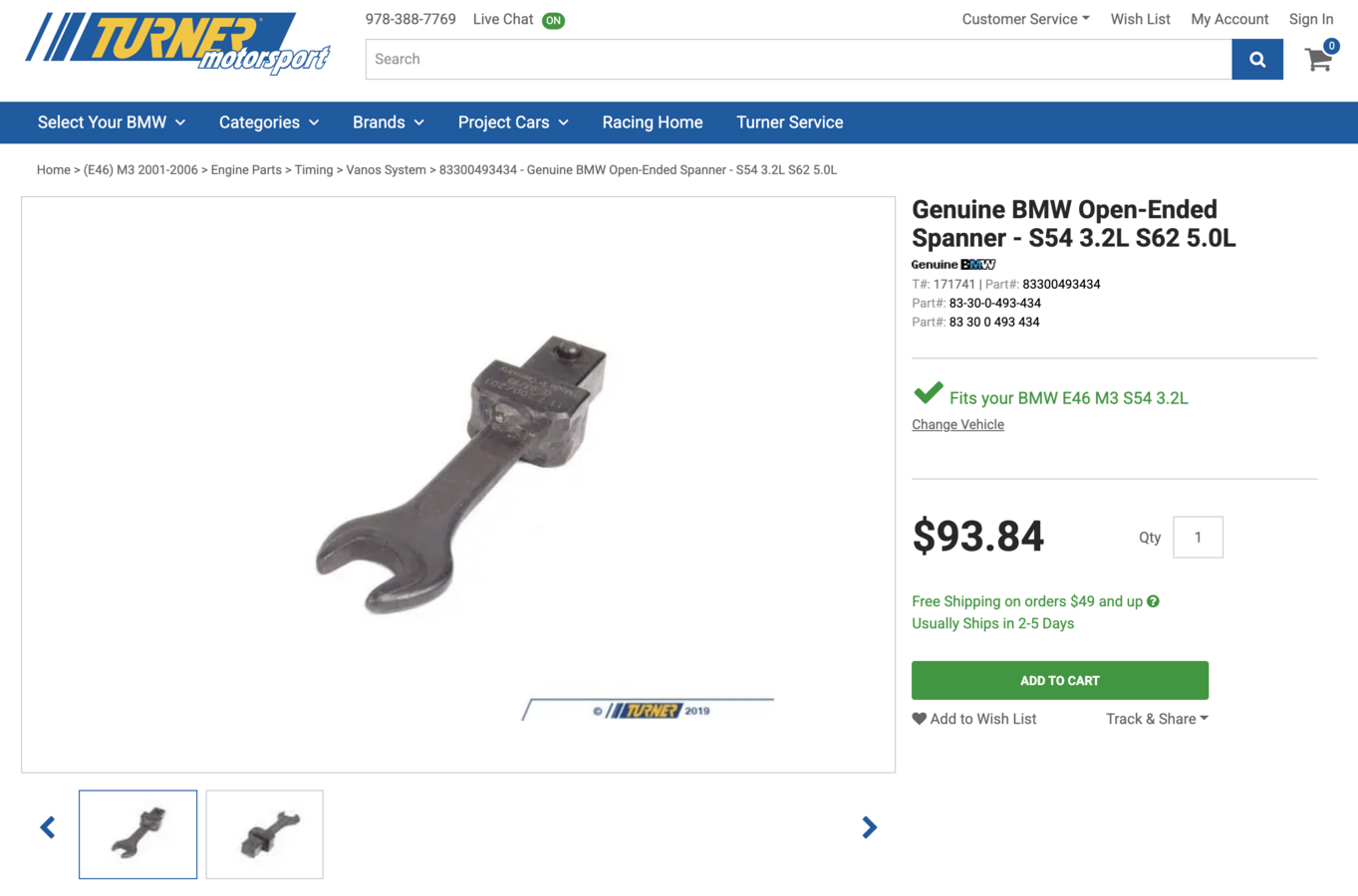

Name:	Screen Shot 2021-01-12 at 10.30.47 AM.png

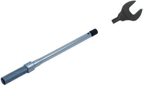

      It's meant to be used on one of those torque wrenches with interchangeable heads. Something like this:
      Sure, the adapter and torque wrench are made so that the readings on the wrench will be the torque that is applied at the fastener. But once again, if you do the math (or use a trusted calculator) and set your torque wrench to a value that will yield the desired torque at the fastener, there is nothing wrong with using a crowfoot adapter.

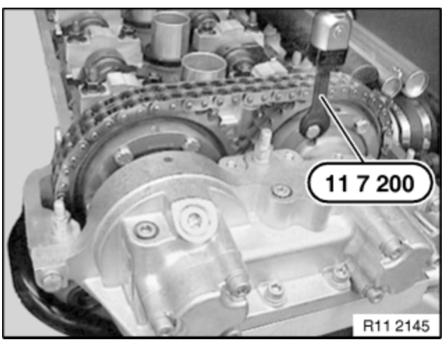

          This pic shows the open wrench is not a normal crowfoot but a torque wrench by itself.
Name:	Screen Shot 2021-01-12 at 10.47.42 AM.png
            This pic show the open wrench is not a normal crowfoot but a torque wrench by itself.
            Sure, but a crowsfoot used at a 90 angle from the wrench results in the same torque (or you can do the calculation like heinz describes above, if you use the crowsfoot wrench inline with the torque wrench). Crowsfoot wrenches are cheap and get the job done while having the VANOS and hub splines mounted (no guesswork needed for the spline depth).

                A crowfoot is a short open wrench with a square hole at one end for any standard 3/8 drive. The 117200 tool is not a crowfoot, but a special insert to use with a calibrated torque wrench. I agree that one can use any crowfoot for this task if doing the math to compensate for the offset, but why need to add more maths and complexity to the task which is prone for error? Why not deviate the Tis slightly so we can use a standard torque wrench with 10mm socket? I also prefer a socket over an open wrench when torquing anything.
