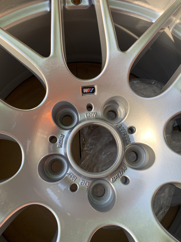

    AWE46M3 I had the car out of storage on the weekend and have taken a few pictures of the wheels.
    Note, they were refurbished around two and a half years ago and have covered ~15,000 miles (including a few track days), which has resulted in a few minor chips.

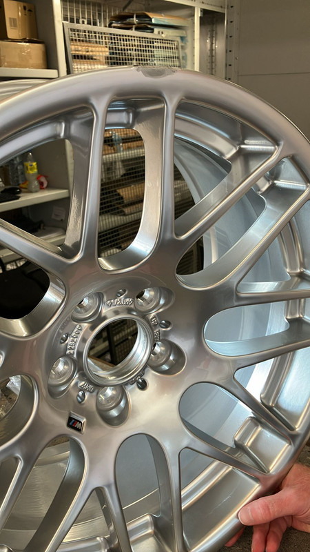

      Hi Kimbo,
      I had mine done by Wheelworx in Ipswich, they even do the matt grey finish on the barrels:
      Obviously you can never truly get the original BMW finish without the silver tint in the paint as previously stated:

        Thank you very much for the reply Mike RT4, can I ask are the last 2 photos you added after the refurb or the pictures prior to that? Mine currently look like the first 4 you added but just missing that shine! 😩 but the last two look stunning!😍

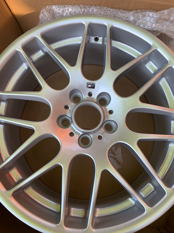

          The last two images are the pictures of the original factory finish.

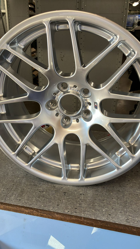

            Courtesy of Prince Wheel in the Charlotte NC area. I believe their claim to fame was their work with style 65s/chrome shadow and there are forum members who have used them in the past with varying reviews.
            Anyway, mine are missing that signature blueish hue in certain light/angles but there is a glossy-ness (?) that the factory spec has. I sent pics of factory fresh rears I have on the shelf before-hand and they did connect me with the tech who mixed and applied the powder. Staff was pleasant to work with.
            overall, im happy with the results.
            edit: I’ve been meaning to pull out a rear and do a side by side, but being lazy. Maybe ill do this and update
