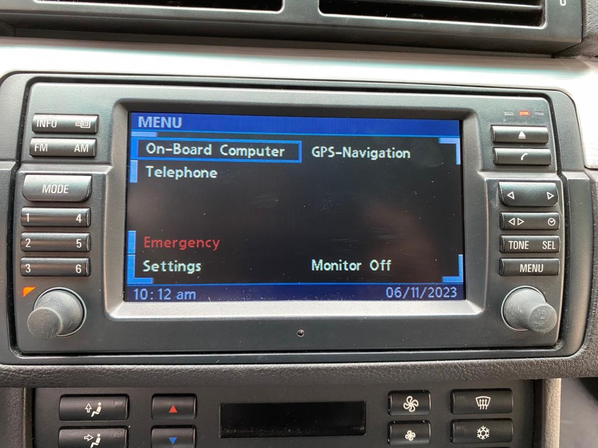

                Here is a picture of the new screen. My old one was "faded" looking, even with the monitor off. is there a coating on there that comes off overtime?

                  The stock nav screen has a matte finish that looks like a coating which requires care in cleaning and maintaining. This is why all aftermarket dash units look cheap and, well, aftermarket in a bad sense.
                  I'd assume fading from uv exposure and long service life as well as harsh chemicals or improper cloths would lead to degradation of the screen finish over time.
