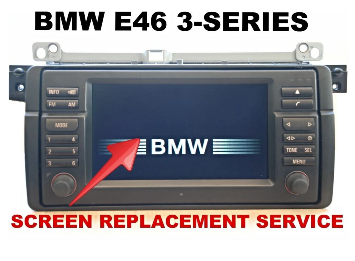

    Looking to get my screen replaced, has anyone used ether of these two companies?
    This is a professional repair service to replace the display/screen on your 2000 - 2006 BMW E46 3-Series, M3 OEM 16:9 Wide-Screen Navigation monitor. This is the best way to have a Brand New looking navigation monitor without the paying outrageous cost of at a replacement at the BMW dealer. Trust the best. With over 20
    Any good? Any others out there I should look at?

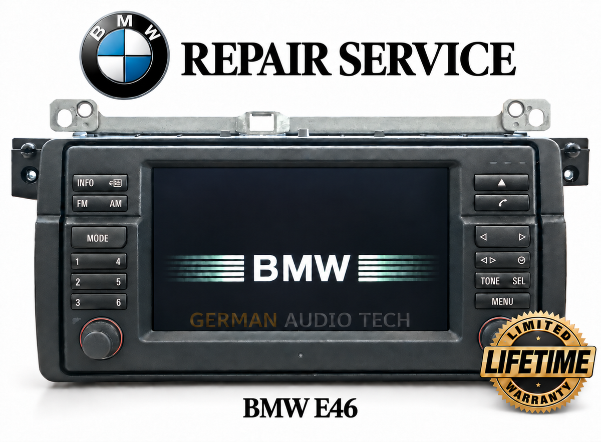

            GermanAudioTech is rubbish. I had them replace my display but they did not adjust and refused to fix! So much for their “lifetime warranty”. The display they use appears to be very cheap too unfortunately, I will need to find another company to do the job properly with a quality display.
