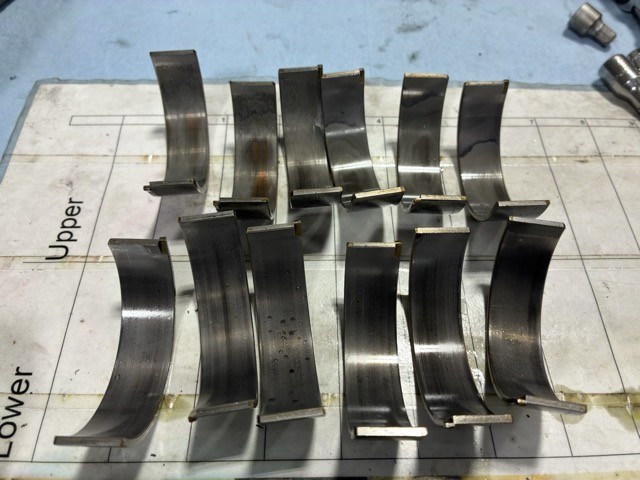

    '06 car, 105k miles on the odometer. Rod bearing history is unknown, I assume they are the originals.
    '06 cars didn't have bearing recall, so these are original, your timing is perfect for a new set.

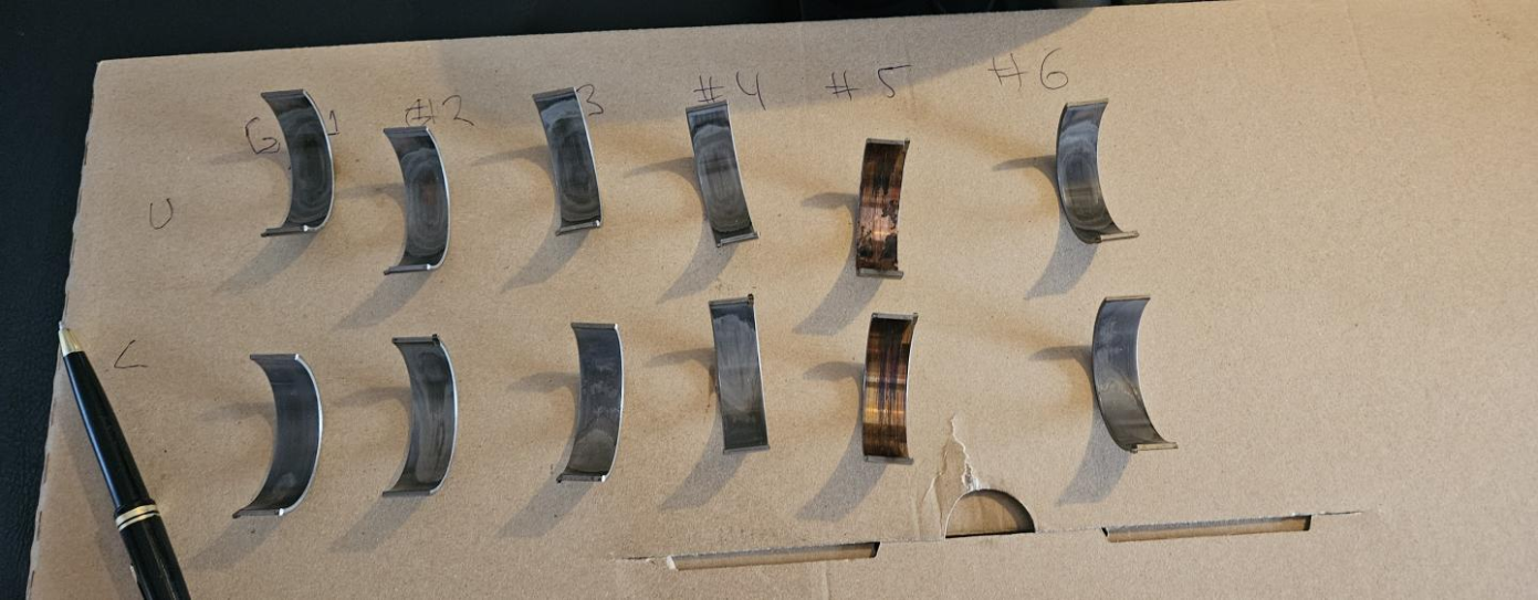

            My 2004 Vert at 135000km / 83000 miles - I am the third owner having picked it up in 2012 and there is no doubt my car was treated like crap prior to my ownership. The number of half assed repairs and simply wrong things I had to correct in the first 3 years of owership was nuts.
            Click image for larger version  Name:	image.png Views:	0 Size:	857.4 KB ID:	360748
            Number 5 definitely spun at least once, given the witness marks on the back of the bearing. Near as I can figure, the tangs kept it from spinning more than a few times since they're still intact. I got incredibly lucky twice: first, that I didn't grenade the entire engine, and second, that nothing blew up after I completely missed those witness marks, threw new OEM bearings in, and buttoned it back up.
            Click image for larger version  Name:	image.png Views:	0 Size:	91.6 KB ID:	360749​
            Since then, I've put 20,000 km (13,000 miles) on the car and while the very first oil analysis after the replacement showed elevated Copper(12ppm) and Lead(19ppm), the last three reports have come back clean with nothing in the filter and no cold start knocking.

              Ramage WOW, that is impressive. Glad you got that sorted out!

                Nice save.

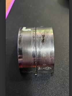

                      '03 Coupe, 180k miles. Unknown history. Dug into the rod bearings the day after we drove the car 160 miles home from purchase. One bearing had spun(#3), but it must have JUST spun as no heat discoloration and no damage to rod big end or crank journal. Bearing felt just as tight as others insert into to big end and clearances checked out. We got super lucky.

                          2005 with 134k on the original bearings, a bit of copper showing on a few. Oil pump upon inspection had wear marks enough to require replacement.
                            These 134K bearings are in the same conditon as the previous posted bearings at 85K, a 50K miles difference. Maybe this car was on longer trips with less wear.
