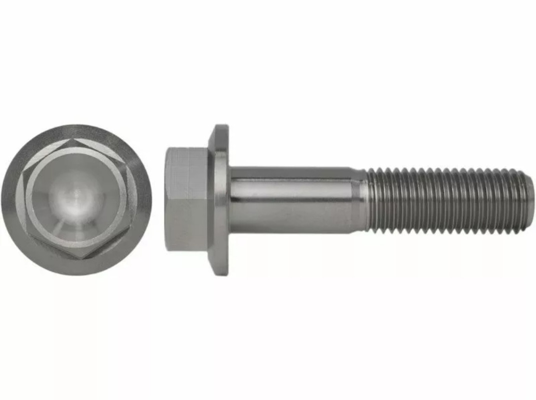

        About the Diff bolts info, there's a small misunderstanding at the explanation. First gen diff bolts were fully threaded, the upgraded now are partially threaded. (the text says the same about old/news, I'm assuming it's a writing mistake).
        Supposedly the full bolt threading was the culprit of broken bolts for what I heard/read...
        By the way, I don't know in your country, but here in Spain now, if you want to buy them at the stealership (23001222891) they ask you to buy a pack of 10, when in the past I bought them separately for my ex E46 M3... So that was like near 50+ euro lol
        Anyway, you can buy them at any specialized store for cheap, just taking with you the bolt measurements, which appear at the realoem. Bought a pair for 0.18 euro, only difference was the head, mine now are hex.
        Added two washers.
        M12 x 50, structural resistance 8.8 (realoem)
        (DIN-6921 8.8 for a local search) you can select the finish, black, chrome, zinc-ed or not, the threading distance measurements, etc...
