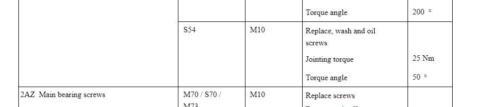

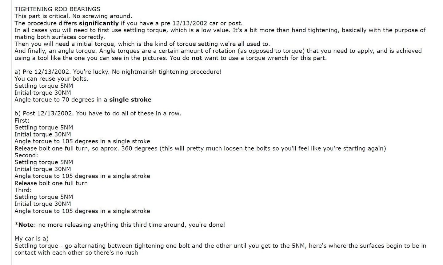

    I am thinking about doing rod bearings on my 2006 M3 while in quarantine, since I need to replace the oil pan gasket anyway. However, I am finding mixed information regarding the torque specs for the connecting rod bolts for the later cars with M10 bolts. Can anyone who has done rod bearings on a Post-2002 S54 chime in and tell me which ones of these are correct?
    Source 1 - "SYT_Shadow"'s DIY from the old M3forum

    Source 2 - FCP Euro Product Page
Name:	Rod Bearing Torque 2.JPG
    Source 3 - BMW Workshop Manual from here https://workshop-manuals.com/bmw/3_s..._engine_block/
Name:	Rod Bearing Torque 1.JPG
    #1 - http://www.siwilson.com/BMW/Service_...20Bulletin.pdf
      Thanks! I looked at this but didn't see it specified torques for the M10 bolts too
        Looks like it is on page 8
        5-30-105
          M11 (reuse) for pre 12/13/2002 -> 1x (5Nm, 30Nm, 70degrees)
          M10 (replace) for post 12/12/2002 -> 3x (5Nm, 30Nm, 105 degrees)
