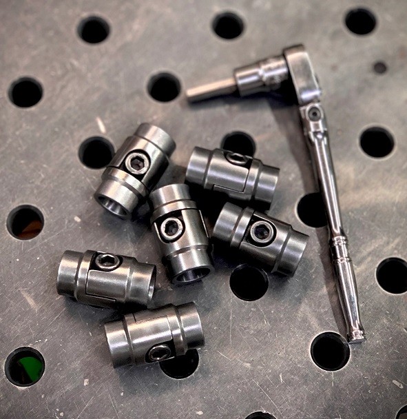

    Links to the tubing connectors you used?
    they have interlocking and non-interlocking. the ones in the photo look like non-interlocking versions. They're called tube clamps

    True, I don't see anyone buying those for an unknown gain.
    I believe that pic belongs to Brandon of dmg.

  • eacmen
    replied
    Originally posted by Feffman View Post
    Modified my Rogue Engineering brace (great product by the way) to be able to remove the center section. Cut the brace (photo 1), the purchased tubing connectors (photo 2)
    and spliced them in with tig welding. Final photo is a quick spray paint to get me through Summer. Over the Winter I'll pretty up the welds, media blast the entire bar and have it re-powder coated.
    Feff

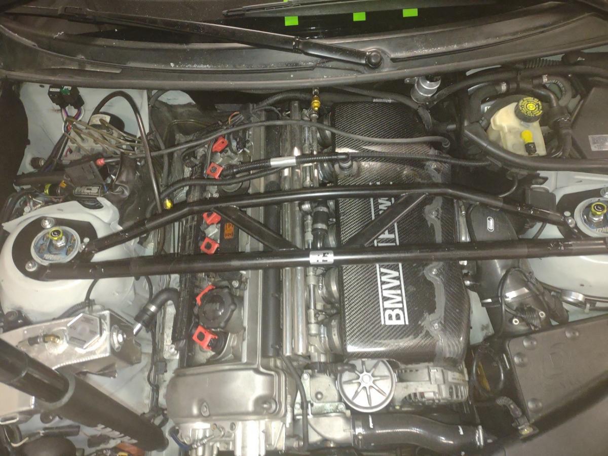

  • Feffman
    replied
    Feff

  • WestBankM4
    replied
    Bought a DMG, haven't put it on yet but I opted for one solid piece, no joints.
    Had some engine electrical gremlins that look to be sorted now, so I'll probably end up putting it on. Like others said, engine work is more of a pain.
