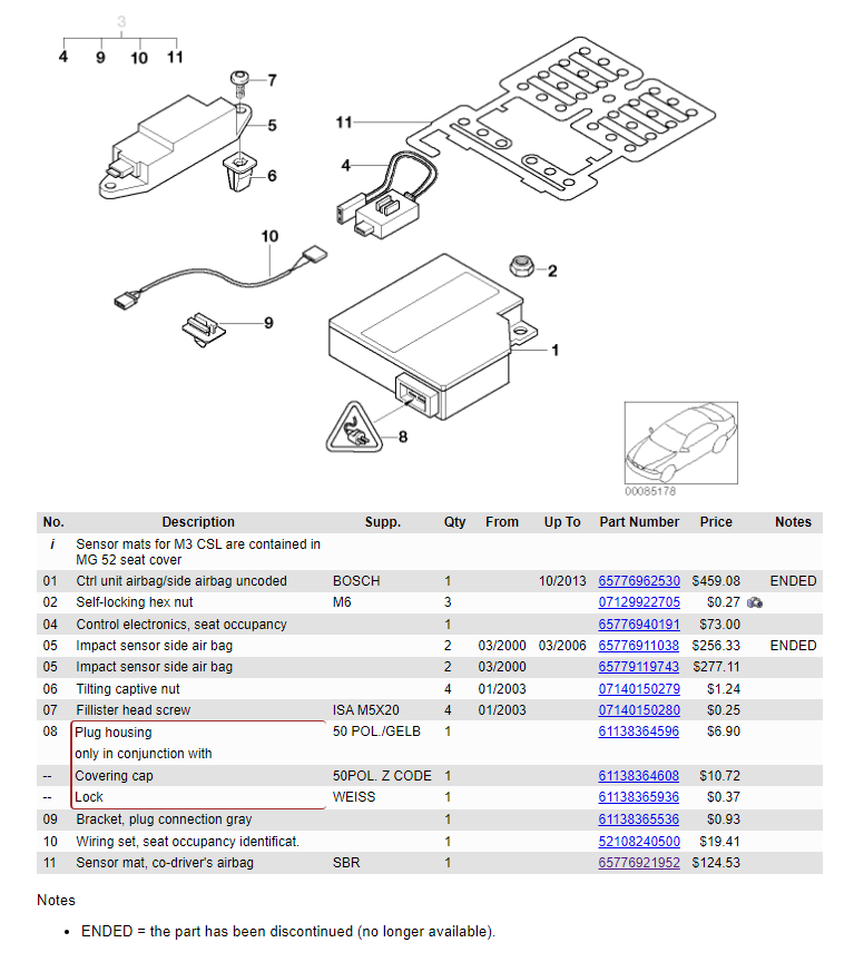

            I recently had heated seat mats retrofitted to my car (used all factory parts) but after my upholsterer finished his work, I'm throwing a passenger side occupancy sensor code and airbag light.
            I need to take a look under the seat to make sure everything is plugged in properly, but do you know what part number you ordered?
            I attached the parts diagram from RealOEM.

              Yes, should be 11
