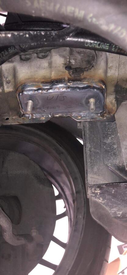

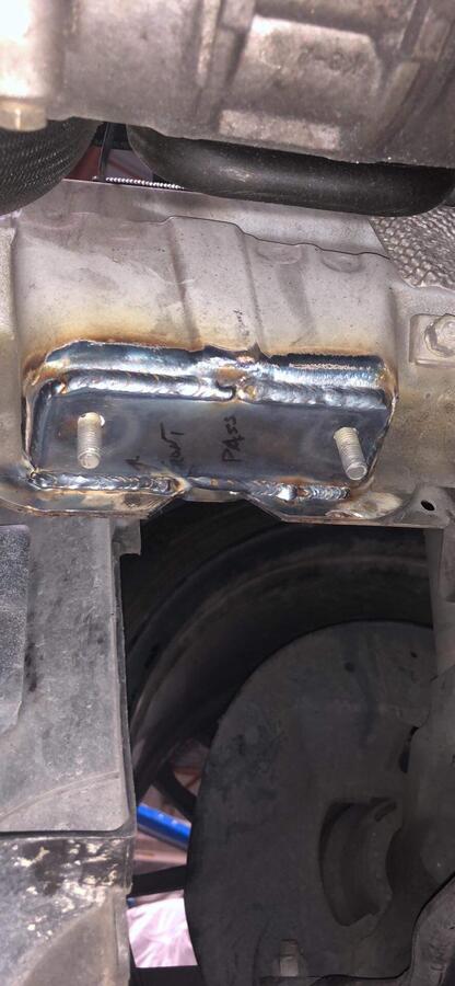

          The shop that repaired/reinforced mine put some thick plates on. If you’re not in a rush, I can measure in a week or two.
              Appreciate it man, yes no rush, whatever's convenient for you. Ontario is on COVID lockdown so I likely can't get back in the shop for some time anyways.
