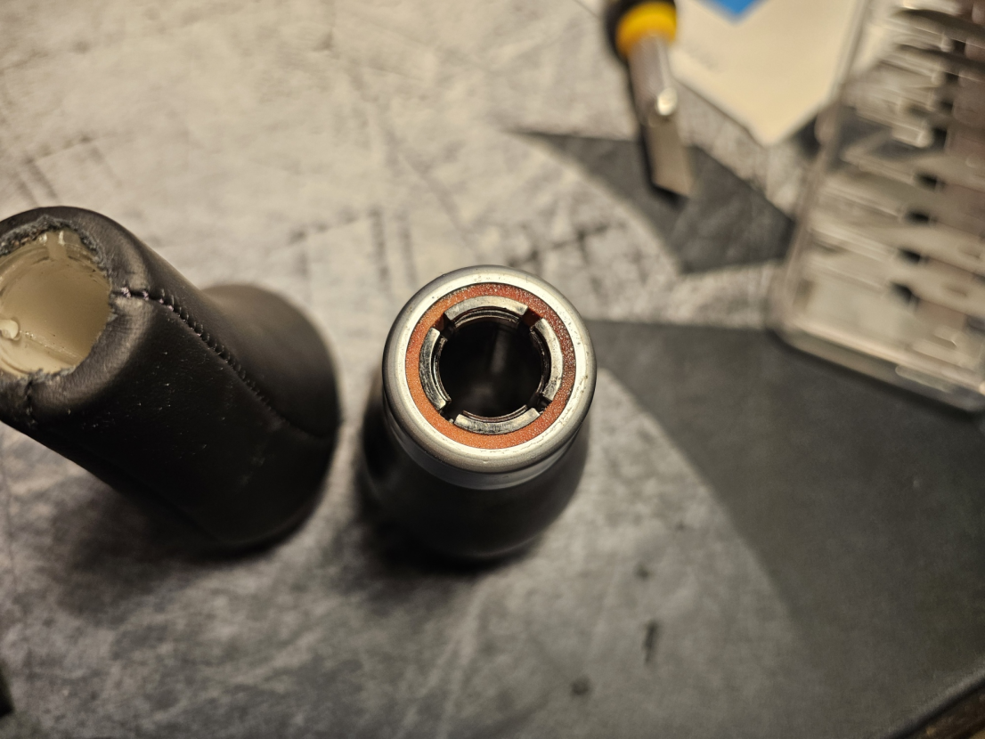

Why do some people prefer the broomstick E46 M3 shift knob over the ZHP shift knob

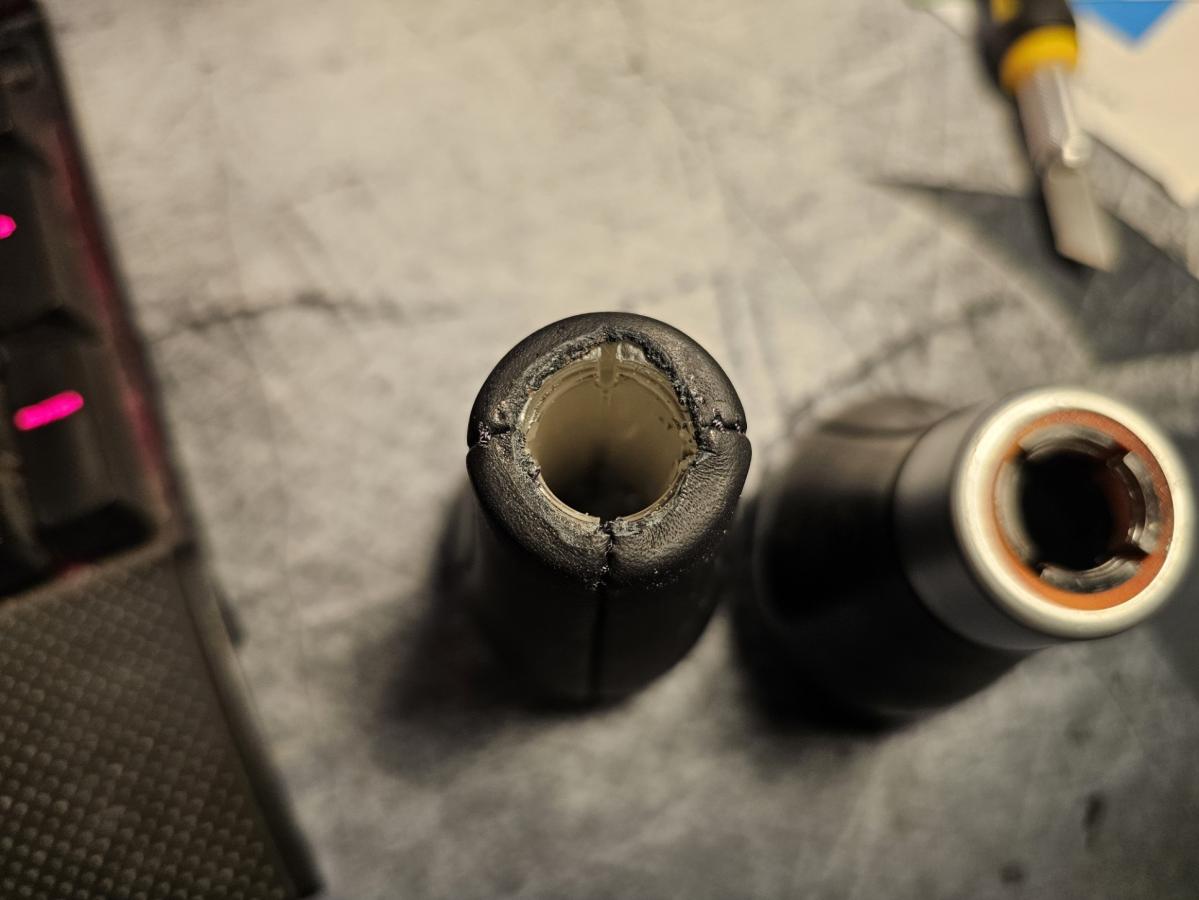

    I wonder if i'm not actually clicking in all the way due to how the leather is wrapped around the bottom of the 884 knob vs. ZHP. I probably need to trim some of the leather to expose more of the plastic insert?

    Click image for larger version  Name:	image.png Views:	0 Size:	944.6 KB ID:	357979​update: holy crap I finally got it to click on.

      It needs a good wack to click, but it sounds like you got it.
        yeah, I was giving it some good open palmed whacks but it finally clicked when I pushed down with a little side force.
        Can't wait to try it out again. I really liked the extra leverage.
