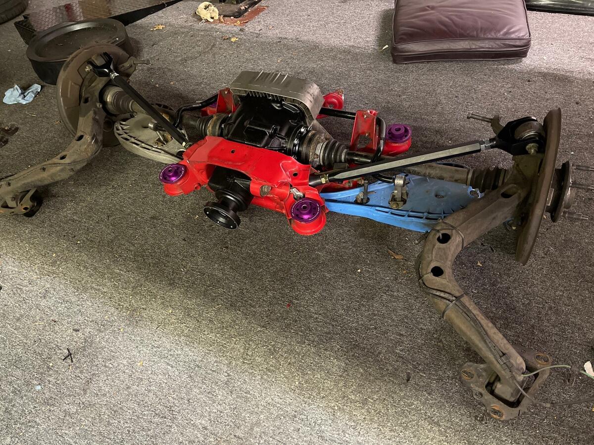

        Those control arms are a bit hard to push bushings into/out of. I cracked one of mine, with the result that I now have one blue arm and one alu arm
        Click image for larger version  Name:	asdfs.jpg Views:	0 Size:	292.6 KB ID:	88038
        Pic from last week, as I'm currently doing a Vincebar, wavetrac diff, CMP subframe mounts, and monoball lower arms.
