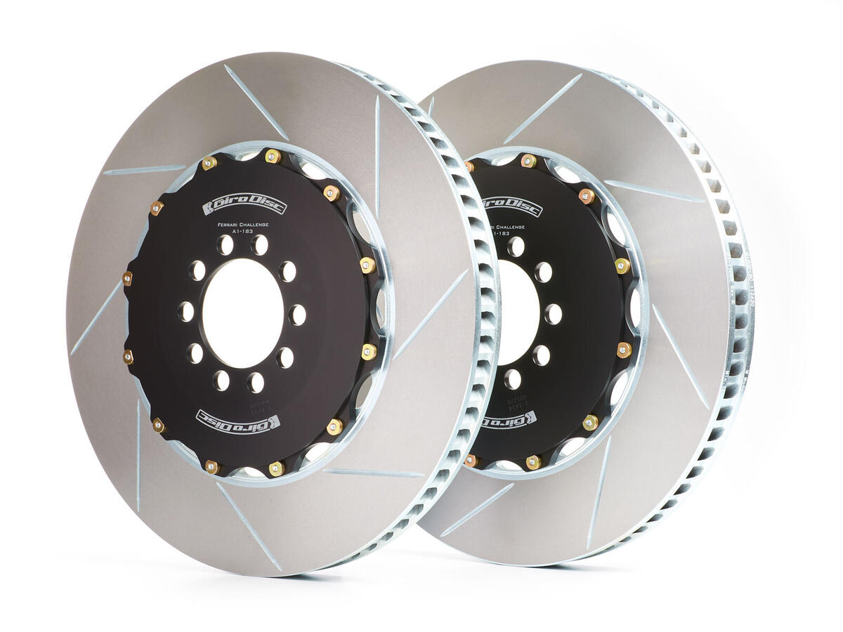

    Hat: We machine them from 6061-T6 aluminum that is sourced domestically. These will be black hard anodized (see attached photo of our 458/488 Challenge rotors for an example). Floating hardware consists of cadmium-plated pins (machined in-house as well) and 12.9-grade hardware using a combination of Belville and spring washers for full float. This means they won’t rattle around on the street but can fully accommodate the iron disc expanding & contracting with heat.
