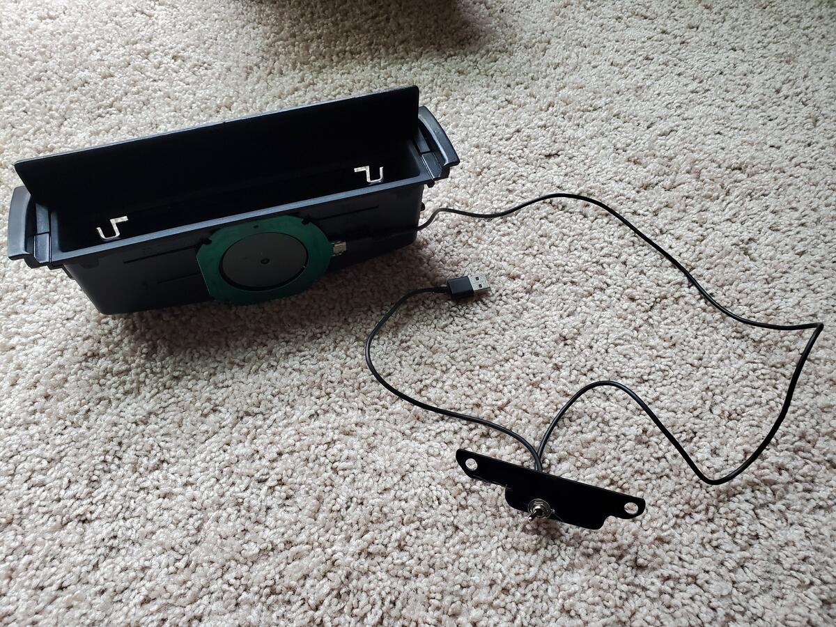

    Now that everything is off, it's time to mock up the wireless charger placement. This is what worked for me:
    Click image for larger version  Name:	20200409_124658 copy.jpg Views:	0 Size:	139.0 KB ID:	8852

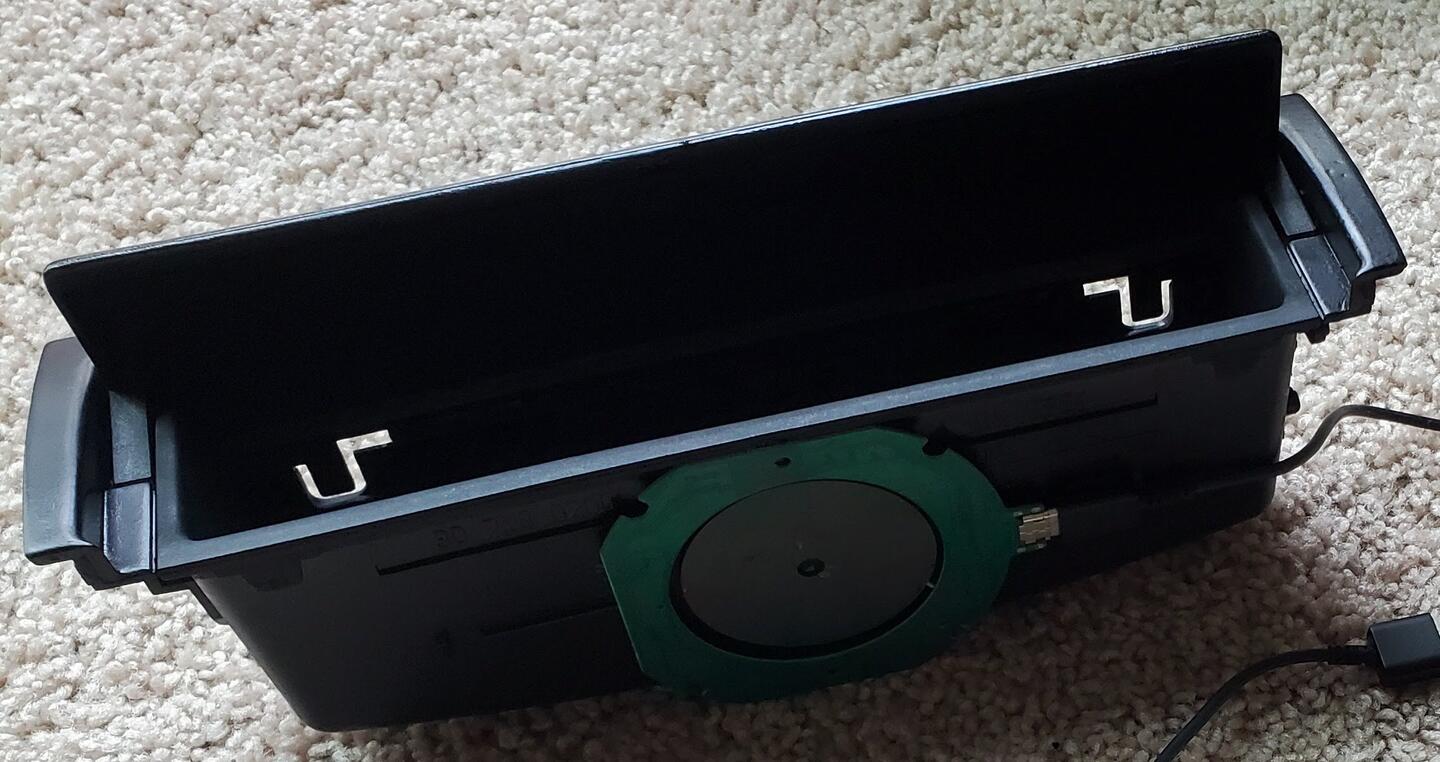

    I attached it to the cubby using double sided gorilla tape. I also secured the tip of the power cable with it to make sure nothing comes apart during use. The cubby does not fit back into its bracket with the charger attached, so time for some notching. This is what I ended up having to remove:
    Click image for larger version  Name:	20200409_125919.jpg Views:	0 Size:	114.9 KB ID:	8853
    Having this notch allows for the cubby to freely slide in and out of the bracket. I did play around with mounting the charger to the bracket, but this put it too far away from the phone and the charging didn't work.

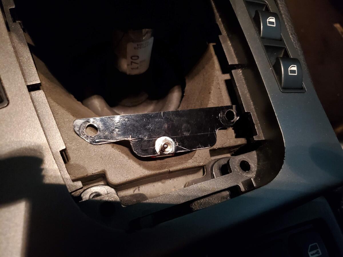

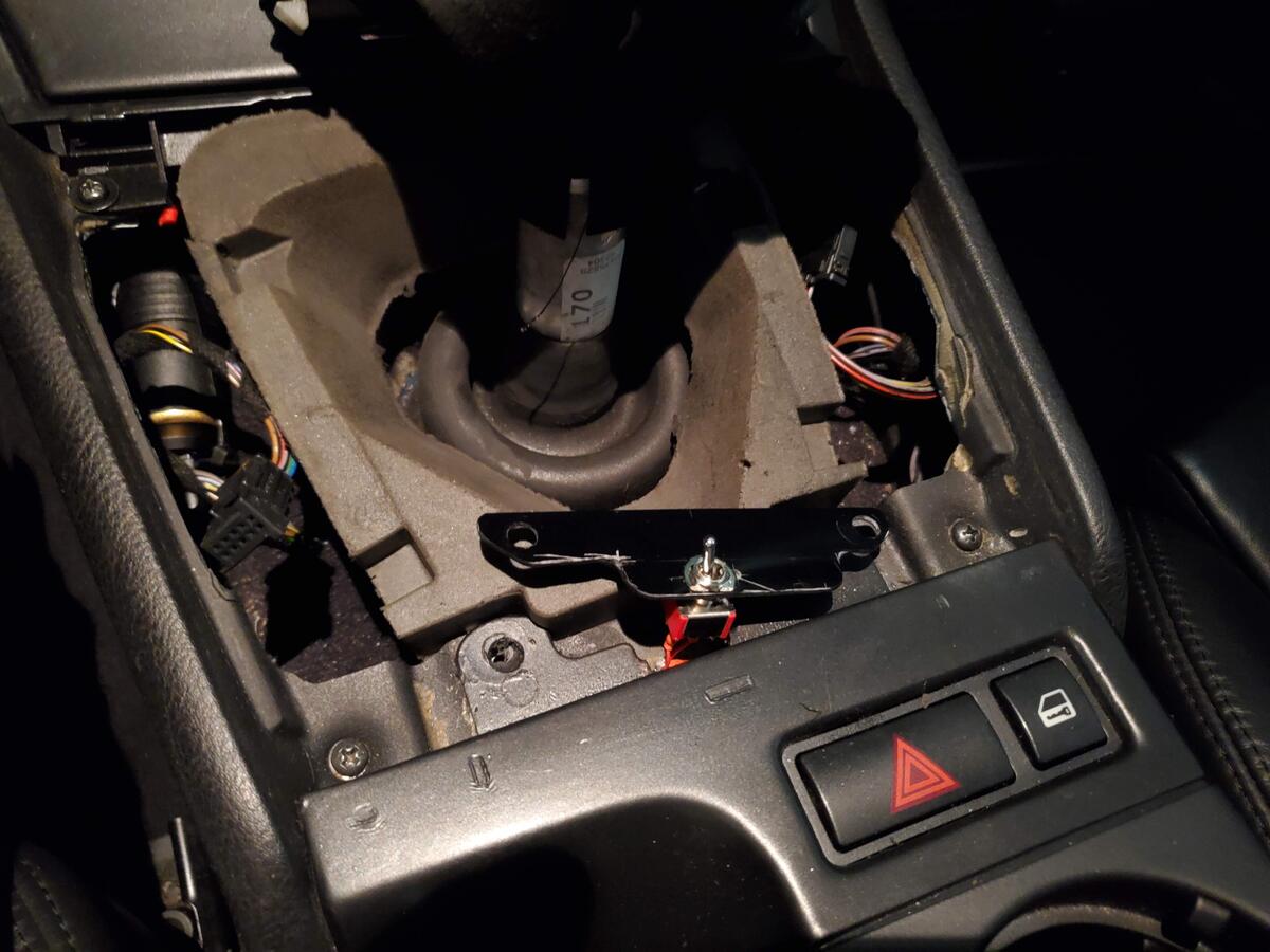

    I decided to mount the power switch beneath my shift boot, so that it would not be visible with everything installed, but I could still easily access it while driving. To do this I created a bracket that attached to the shifter surround and holds the switch. This is what it ended up looking like:
    Click image for larger version  Name:	20200409_115534.jpg Views:	0 Size:	103.4 KB ID:	8854
    Since the cigarette lighter socket that's been added also feeds my dash cam for parked recordings, I decided to wire the switch into the USB cable instead of the power cable going to the cigarette lighter socket. I stripped the insulation off and wired the switch into the power wire in the USB cable.

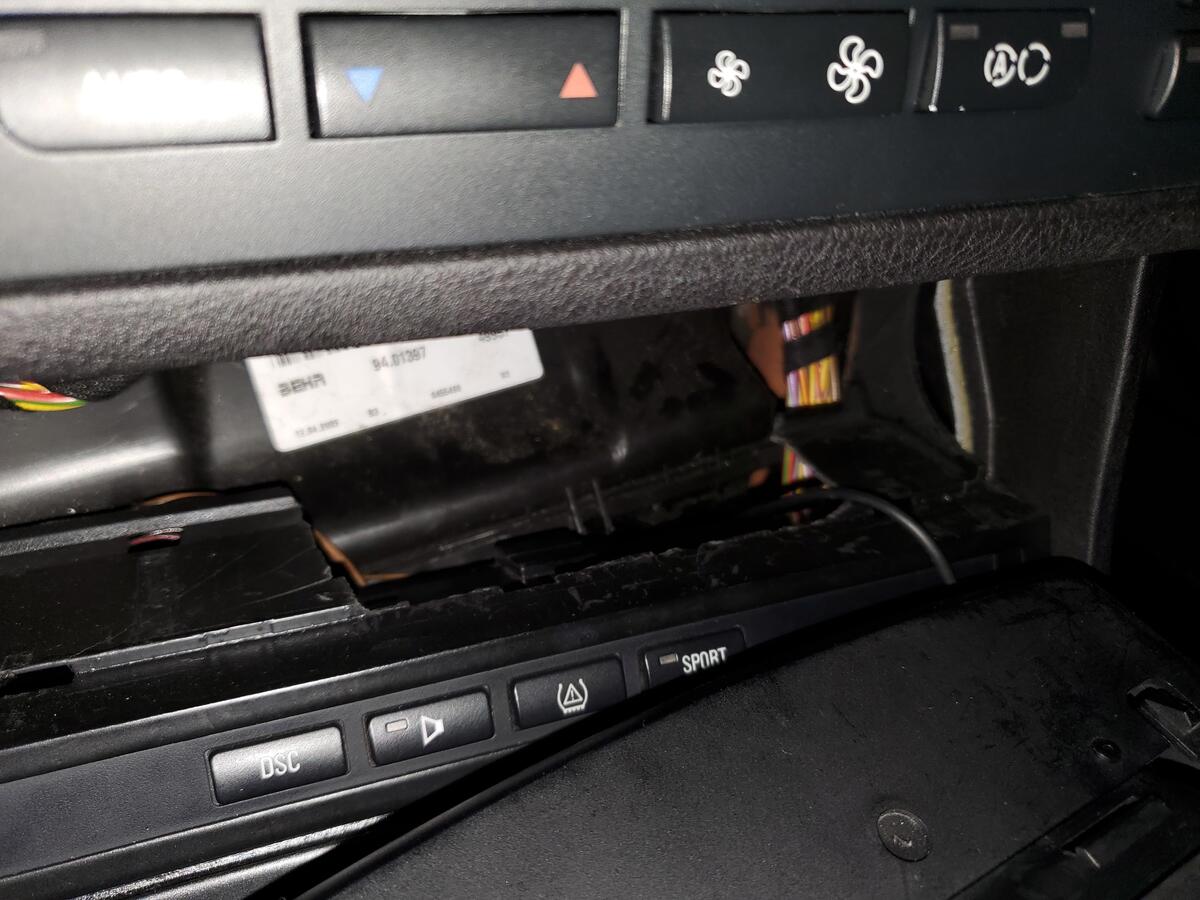

    Now it's just a matter of reinstalling the bracket below the climate controls (and plugging in all the connectors that go to it), feeding the USB cable through the notch and out by the shifter, and reinstalling the storage cubby with the wireless charger.

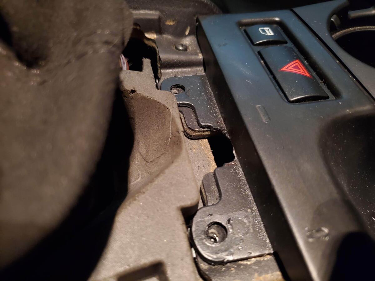

    A bit more notching is still required to get the switch to fit. The center console needs to be notched between its front screw mount holes to allow the switch to pass through. This is how it should look:
    Click image for larger version  Name:	20200409_115551.jpg Views:	0 Size:	90.9 KB ID:	8856

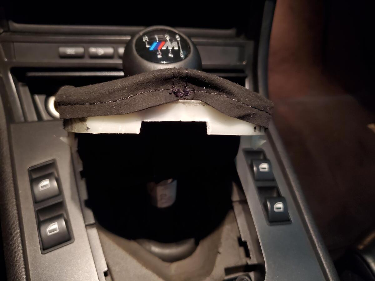

    Last thing to notch is the shift boot mounting ring thing. This might not be necessary depending on the type of switch you buy, but I found that it was really hard to reach the switch without it. Here's how much I ended up removing:
    Click image for larger version  Name:	20200409_115258.jpg Views:	0 Size:	75.7 KB ID:	8857
    With all the notching done, the switch and USB cable can be routed to the back of the shifter surround and mounted.
    Click image for larger version  Name:	20200409_125508.jpg Views:	0 Size:	106.8 KB ID:	8858
    You can see the additional cigarette lighter/USB charger assembly thing at the top left. I decided to leave it there for easier future troubleshooting since removing the shifter surround is significantly faster than removing the other bracket. There's a ton of space beneath the window switches so fitment is not an issue. This is how the switch fits with the shifter surround:
    Click image for larger version  Name:	20200409_115226.jpg Views:	0 Size:	99.9 KB ID:	8859

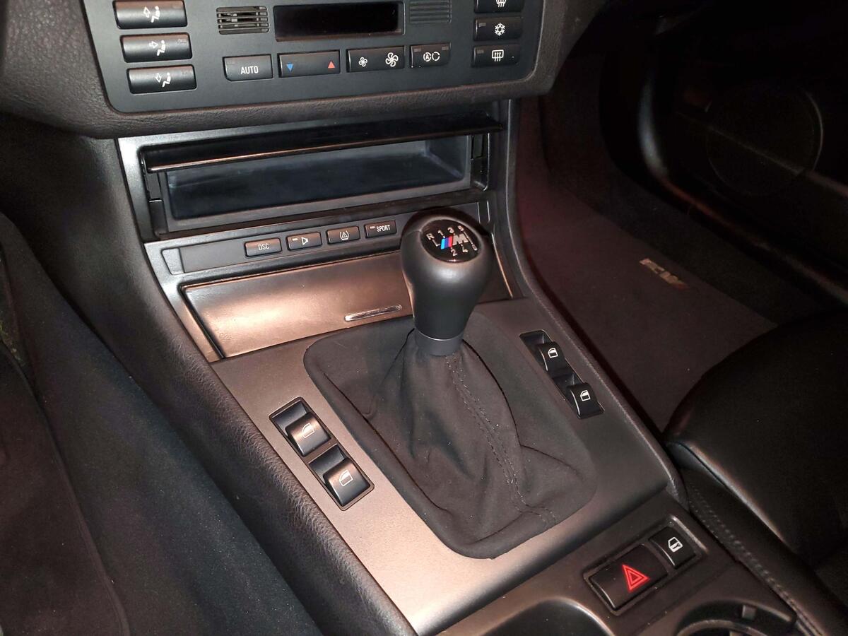

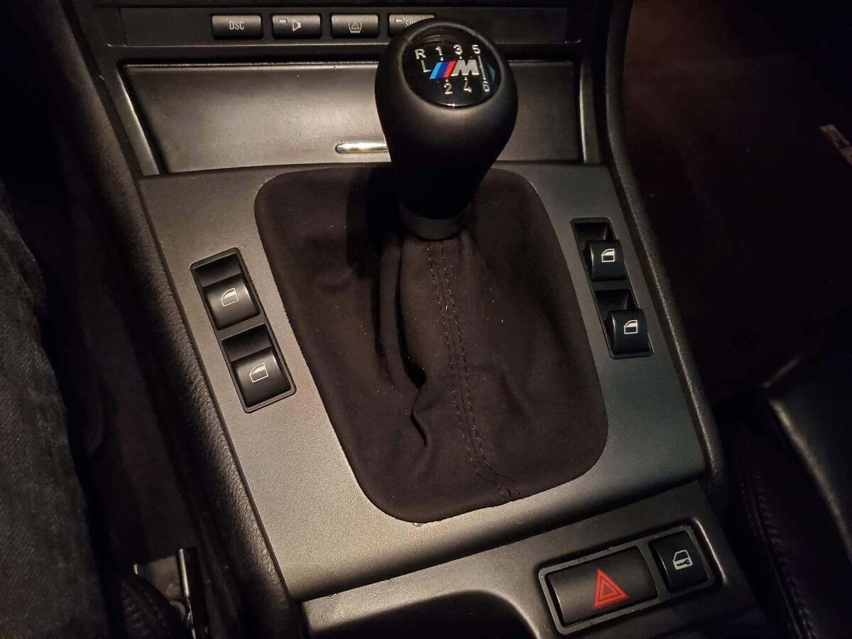

    The screws holding the shifter surround and the shift boot can go back on (and shift knob if you removed that too) and you should be done. This is how things look when everything is back together:
    Click image for larger version  Name:	20200409_115407.jpg Views:	0 Size:	93.6 KB ID:	8860
    Click image for larger version  Name:	20200409_130154.jpg Views:	0 Size:	108.2 KB ID:	8861
    It looks completely stock, no notches or wires or switches or anything are visible and since the switch bracket sits above the shifter surround, trim fitment is completely stock as well. Also, having the switch at the bottom does not interfere with shifting at all.
