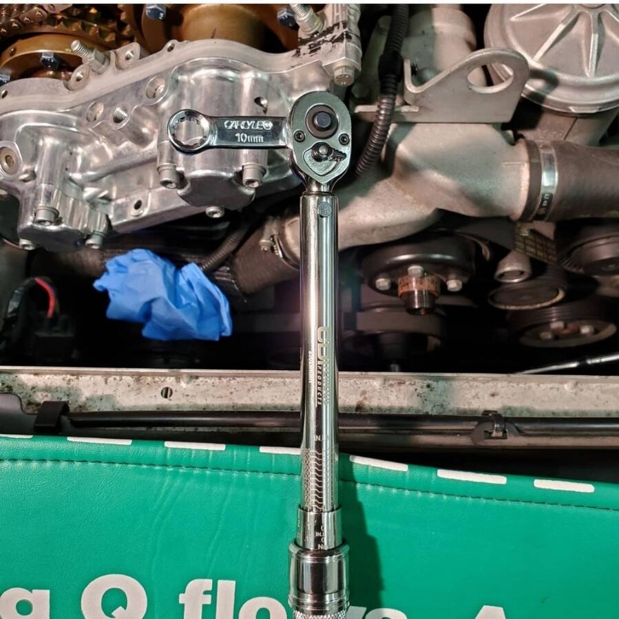

          I was bothered so much by not being able to torque the bolts properly with vanos installed that I just about bought a CDI removable head style torque wrench and the head for the hubs bolts, that was going to be about $300.
          I followed Sapote's advice and torqued down the bolts with vanos removed. But then my timing issue kept happening and I was tired of taking the vanos off so many times, I got lazy and re-timed w/vanos installed following beisan procedure.
          I used this tool at 90° to reach the bolts.

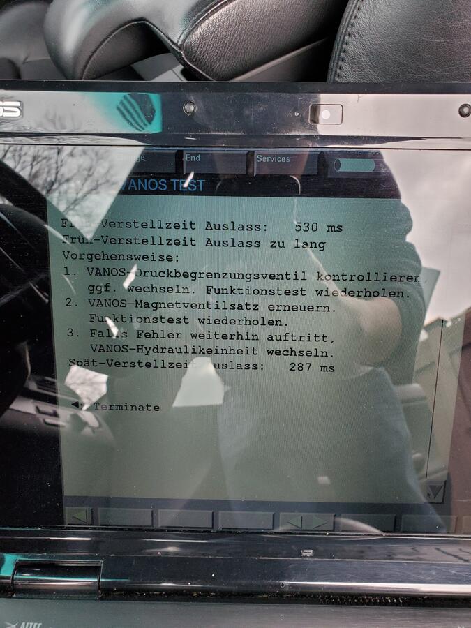

            One last vanos test before disassembly...

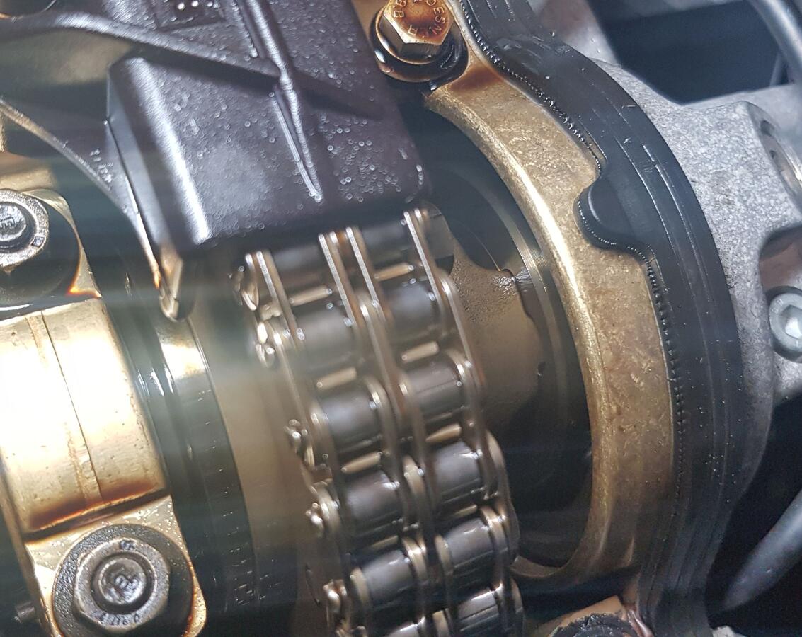

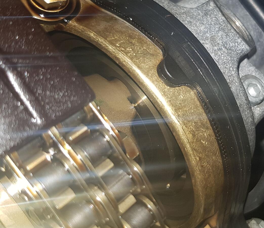

              Now here comes the thought I had when looking at my car yesterday with the valve cover removed. We all know the exhaust hub and the disc are in contact, this is evidenced by the marks we always see on the OE disc, and the image below
              When I looked at my car yesterday I was surprised to see so much separation, as I do remember my car originally was as per the image above. I did not measure the gap, but is in the range of 2-3mm (Beisan Disc).
              what the above means is that the disc can move fore / aft (driver perspective) as the pump operates affecting pump efficiency, this also tells me I have way too much preload on those cup washers, as by design, the hub and disc should be in contact.
              the above for sure would be a problem for response time, as the cup springs have too much preload and the same pressure will actuate the cams slower. I am not 100% sure how much the above has an impact to the pump efficiency (assuming all else is to spec), but for sure there is an assembly deviation. so it is KEY to be able to torque those hubs to spec, or there is just too much preload, and in the case of the exhaust hub, separation from the disc allowing axial movement.
              So perhaps BMW was not as stupid, and the tab sizes and play relative to the disc were necessary to reduce binding forces as the disc is limited by the casting on one side, and the hub on the other. this is just a thought.
              Lastly, I firmly believe the unit has an oil jet that provides oil so the steel disc does not eat through the aluminum, and the step in height is just for that oil to flow out. I think this is an important feature.
              So, there you have it, it could be that the issue has a tie to an assembly problem due to the lack of proper tools to torque those hubs appropriately,
                Wow, it got worst with both cams took 530ms to move.

                      I'm sure the disc rubbing the hub in operation. This is by design to stop the disc/inner race moving rearward any further. The bearing inner race cannot rely on the washer/C-clip to stop it as this will wear out the components. The reason engineer needed the washer/C-clip is to prevent the inner race fell off if for some reasons the disc pistons jumped off the inner race groove.
                        This is mine which is completely untouched. VANOS has never been off to my knowledge. Factory disc, decent pressure (slightly low) and good VANOS test times.
                        Looks like the disc surface is not touching the hub but you can see wear marks too. Smaller gap than yours and none of my multiple photos really show it clearly (I was mainly looking for cracks).
                        These were taken 8 minutes apart just turning the crank by hand. I have the valve cover off now (was doing valve clearances first). I will look again tonight.
                        Click image for larger version  Name:	image_22206.jpg Views:	6 Size:	142.3 KB ID:	93106 Click image for larger version  Name:	image_22207.jpg Views:	6 Size:	135.9 KB ID:	93107
                          During engine stopping the disc might have moved forward with lower oil pressure.
                          100% sure during operation the disc never touched the vanos body (if disc moved forward) as this would leave a wear circular path on both the disc and the vanos body. I never seen one.
                          So turning the cam by hand can move the disc away from the hub tabs, randomly based on the roller bearing natural setting.
                            ^^^I didn't want to mention it before (in case I remembered incorrectly) but that is how I remember mine. I wouldn't call it wear marks but there was less oil staining in those locations.
                              Right, so why the concern about the gap to the hub then?
                                I tried to tell the poster his concern has no ground.
