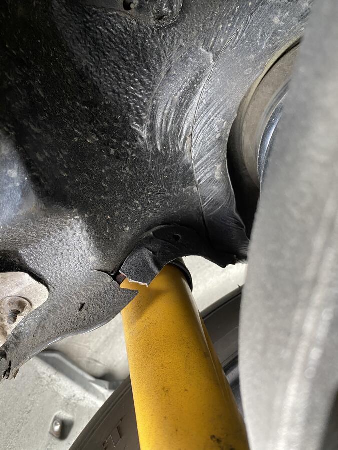

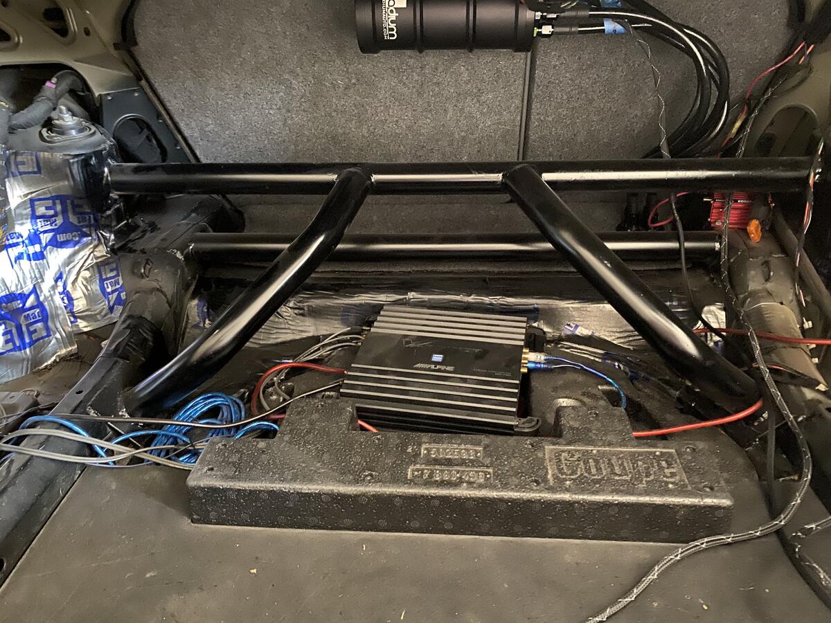

I’m bringing this back again. Mine was reinforced about 5 years ago with maximum psi plates and a bar across the strut towers. They didn’t tie in the front subframe bolts. Today I noticed the floor behind the driver side shock is breaking. I wonder if a Vince bar would help prevent future damage.

I could see why it continued to crack you need the bar to tie into the rear subframe mounting bolts to spread the load to the chassis rail.
Don't waste money on plates. They redirect the load to the same failure point, the floor. Get a Vince Bar. That is the fix. These shops just think slapping some thicker metal on works. That's not how it works. The structure needs reinforced. Plates with the bar are probably ok but then you run the risk of putting the stress in an area the chassis wasn't designed to experience load.This is my Unbuild Journal and why we need an oil thread

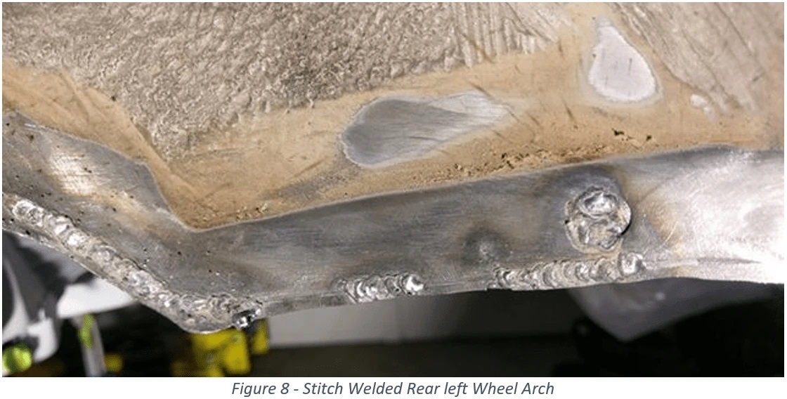

The places that usually show cracks with or without foam are the same, as welding a crack shut in a stress concentration doesn't do much to prevent it form happening again. 1. Inbound of rear left subframe mount 2. rear left wheel arch spot welds and 3. front right mount.

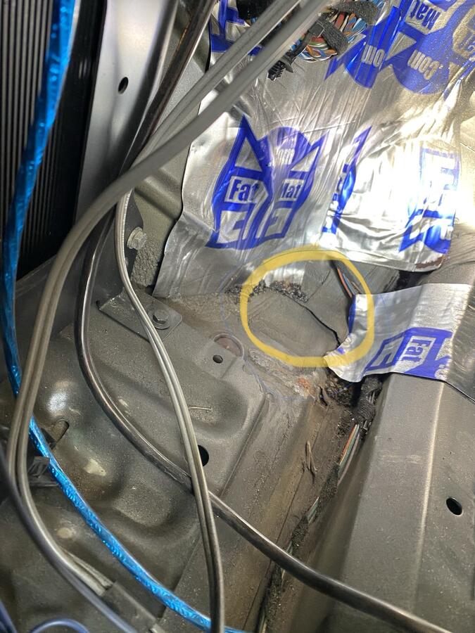

If you find cracks there I'd also have a look behind the rear subframe mounts where the RACP ends as there's 4 spot welds that very often pop and where the chassis rail meets the boot floor running from the back to front mounts. If things get bad enough the rear wheel arch will propagate cracks from the broken spot welds forward alongside the spring perch as per the above post as that's all that's keeping the RACP and chassis together at that point.
Bonus points if you look beneath the back seats along the chassis rail and the furthest forward chassis rail to boot flor spot welds in the corner between the front 2 mount and the spring perch.
