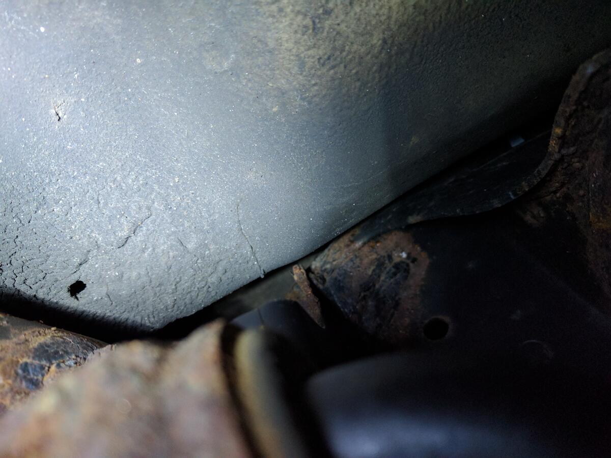

                      Drove my car around for a couple of years, and hairline cracks in the seam sealer in the LH wheel well caught my eye. Went underneath the car and found this:

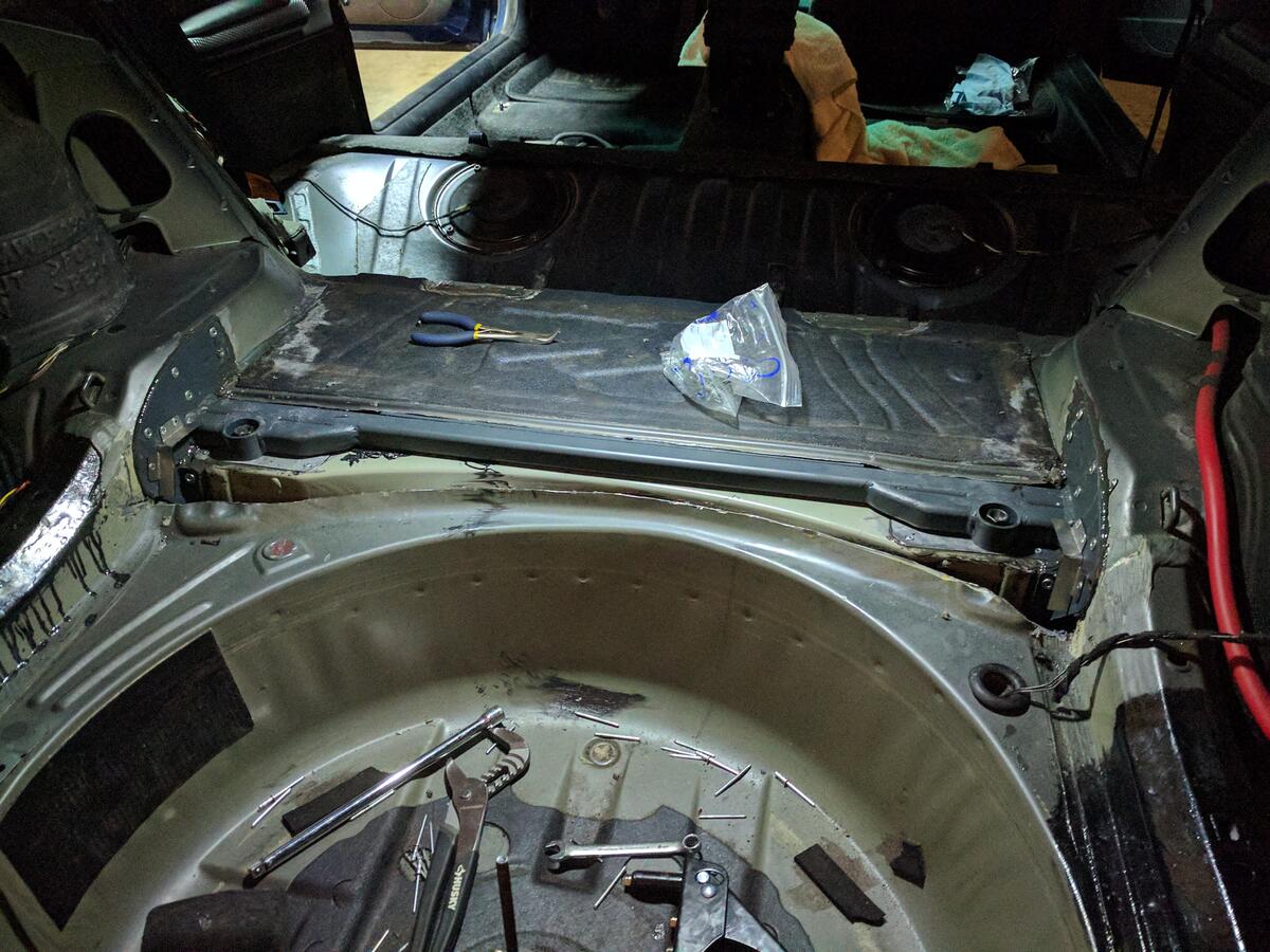

                      Had Redish Motorsport plates installed along with new poly bushings. Then DIY'd the Vincebar to 100% bulletproof it for autox & track:
