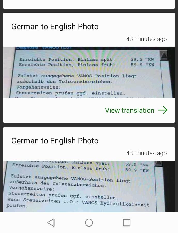

    From that one sample of command to move EX to max advanced position (zero deg is max advanced and 45 deg is max retarded), 5 deg adaptation makes no sense, and so I think the test had performed moving at a few positions and then averaged out the error to a value of 5. You only posted one sample data and so we haven't seen the other values, I think.
    That screenshot (diagnosis) is the vanos adaptation values from a different place in DIS. The test I did stopped after showing me the following intake values, it did not get as far as the exhaust values.
    I am not sure if it is saying it failed on the inlet or the exhaust being out of range (photo below)

      Btw, Neither 60 deg and 0 deg are the correct absolute working cam angles. Their working range are: IN [70: 130] after TDC and EX [-83 : -128] before TDC.
      Are you saying my mechanical timing is 10° off? Because it's stating 60° while 70 is the minimum range starting point?
        #63
        The test did not use the absolute true timing angle, which is [70 to 130] for IN, but it used a relative range from 0 to 60. So 0 is 70 position and 60 is 130 position.
        I think your vanos timing is perfect, as the test didn't say anything wrong.

                    From your test report, I don't see any difference between DME commanded timing valves and the actual values so things look fine, and I don't understand why it used 5 deg adaptation when there is no error in the timing.

                              Questions and comments:
                              Why the test only commanded the vanos to move Intake to 130 deg (max retarded which is an easy motion) and not to 70 deg (max advanced which is a more difficult motion)? And, for the Ex cam, why commanded to to to max advanced (128 deg) instead of max retarded (83 deg)?
                              ISTA test value:
                              For exhaust cam: The actual steering advanced is 128, which is perfect. But the actual steering retarded is 79, which is not too good when the command value is 83 I assume. So 4 deg off here.
                              For intake cam: 70 deg advanced and 130 retarded and so they are perfect with zero error.
                              the DME commanded both, if you look at the images you will see it went to both opposite ends for both cams.
                              about your comment on the exhaust side being 4deg off, that is not the case. The DME commanded 80, and saw 79, that is just 1deg off, and yes, though not perfect, the adaptations would offset that.
                              For the Z4M the results are laid out differently, but values are the same. Also ISTA reports the range that is acceptable for DME, all my values where right in the middle (nominal) except for the exhaust, which was 1deg off from the mid point.

                                Exhaust 5.0 adaptation?!
                                Inlet shows -1.0 (makes sense as pin didn't slide in easy but bridge did lay flat)
                                DIS shows (photo) the same adaptations.
                                Vanos test FAILS?! - WHAT THE HELL IS GOING ON?! (photo)
                                Click image for larger version Name:	Screenshot_20220126_193929_com.microsoft.translator_edit_399006259338073.jpg Views:	0 Size:	68.2 KB ID:	150291
                                ​​​​image widget
                                i translated this, and the message seems to be more of an error during the test routine. I saw you posted after the car passes, but if this was an actual error I would initially thought bad timing or a severe leak through the pistons seals or valve body.
                                “last entered vanos position is outside the tolerance range.
                                method:
                                control times: check vanos hydraulic unit“
