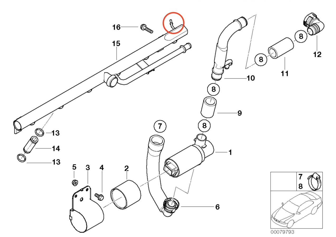

                      Your issue kinda sounds like an electrical one, but I had a slightly shaky idle that was caused by a small vacuum leak at the port in the air rail that leads to the fuel pressure regulator. I managed to knock the hose off of it accidentally when working on something in that same area (its just held on by friction, no clamp or anything).
                      Super simple to check so might be worth a shot to take a look without any prior diagnosis. Remove the cabin air filter housing and make sure there's a hose (that goes down to the fuel pressure regulator) plugged into this port at the rear of the air rail:
                      Click image for larger version  Name:	Screen Shot 2021-03-11 at 11.50.44 AM.png Views:	0 Size:	254.3 KB ID:	90802
                      Again, just a blind guess, but it'll take all of five minutes to check.
