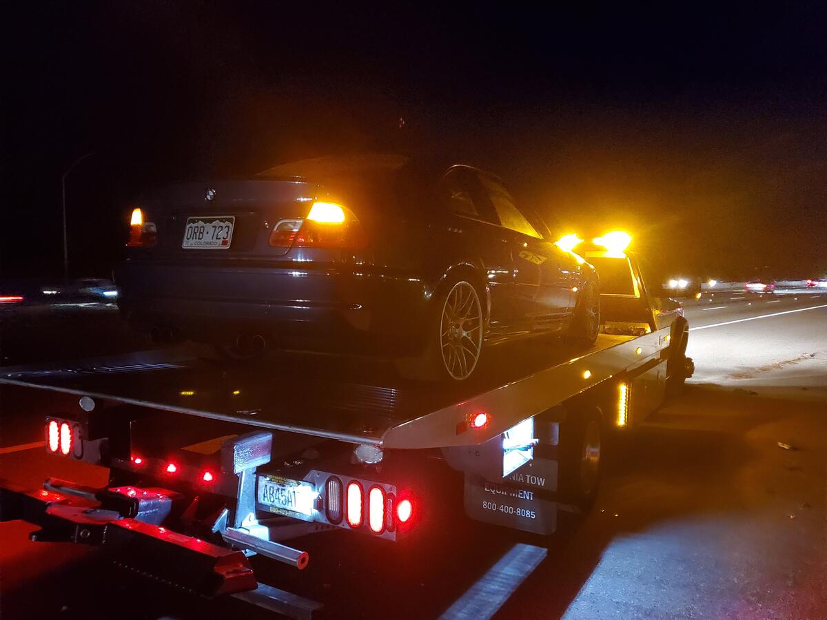

    Want to know when to replace the fuel pump? Drive your car until the pump just gives up and you get stranded in the middle of a busy street. Ask how I know lol
      Yuuuuup
      Click image for larger version  Name:	20191024_205301.jpg Views:	0 Size:	86.7 KB ID:	89820
