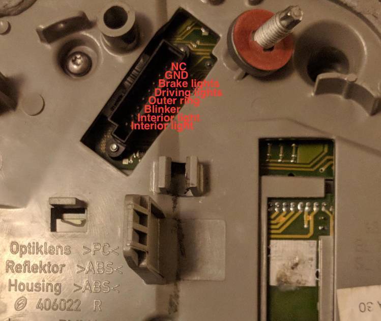

It's just blinking through the brake light and some times it works. Is joist the circuit panel on the light fried?

Both front and rear not working? Turn on the emergency sw and see if all 4 corner lights flashing.

The Amber's are not working. But the brake light is blinking in its place.
With warnings on the amber dosnt blink. The brake light below it does though

Pre or post facelift? The brake light blinking instead of the turn signal means the car thinks the turn signal bulb is out.

It's post. And non of the leds are out

You can try applying 12v directly to the pin that lights up the turn signal to see if it works and go from there
