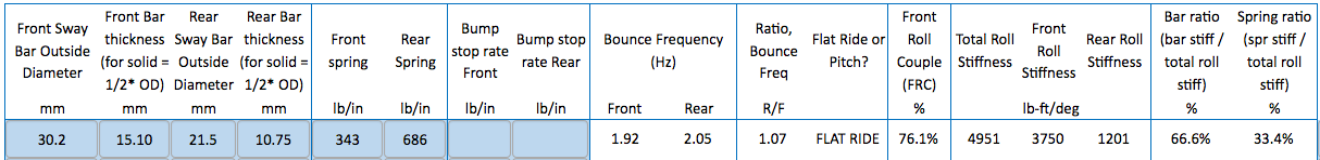

Just finished this project which included CSL king pins, new springs, TMS monoball RTABs, new wheel bearings all around, and 996 Brembos.Originally posted by Obioban View Post
That looks pretty bang on perfect to me. I'd say start your front sway off on medium, and tweak it to taste from there. Medium should put you at 74%, which is a pretty optimal starting point for "medium". I wouldn't worry at all about a 0.4% FRC variance left/right-- unavoidable.

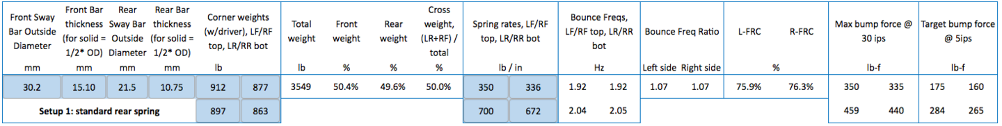

During the first drive, the car felt REALLY bouncy. Seemed to be coming strictly from the rear. I have TCK SA shocks and they are set to 3 clicks from full soft front and rear. Spring rates are 350# FL, 336# FR, 700# RL, 657# RR.
Do I need to adjust the shocks to be more firm? Not sure why it's so bouncy. Any advice is appreciated!2005 BMW M3 ZCP Black/Black - HTE Tuning | Kassel CSL DME | 280/272 Schrick Cams+P54 Followers | Dinan TBs | Bosch 550cc | Radium Fuel System | Karbonious CSL Airbox+OE Snorkel | SS V1 Stepped+Catted Sec 1+Resonated Twin Pipe+Race | 3.91, 3 stage clutch | FCM 336/600 | Vorshlag Camber Plates, RSM | Rogue ASP | AKG FCABs, SFBs | TMS Front Sway, Camber Arms, Monoball RTABs, Pullies | Mason Race Strut + X-Brace | AS 30% SSK | SPAL | Redish Plates | VAC Exhaust Hub | WPC Rod Bearings
You should have the fronts on full soft and rears somewhere in the middle of their range, probably. Full soft up front for sure.
maybe more in the rear— 700 is the stiffest spring tck says your can use with their shocks, so it might need to be on the stiffer side to control it.

Just purely out of curiosity, why full soft up front? Because of the low spring rate?Originally posted by Obioban View PostYou should have the fronts on full soft and rears somewhere in the middle of their range, probably. Full soft up front for sure.
maybe more in the rear— 700 is the stiffest spring tck says your can use with their shocks, so it might need to be on the stiffer side to control it.'03.5 M3 SMG Coupe - Jet Black / Black
Yes. A softer spring rate needs less damping to control it.Originally posted by r4dr View Post
And too much is a bad situation— the car jacks down (over repeated bumps the spring gets more compressed as the shock is too stiff to let it expand in time to hit the next bump), so you end up driving on the bump stops.
Just took the car out for another drive after setting the rear shocks to 1/4 turn from full firm. While its much better, its still bouncy. Just doesnt feel planted when going over bumps.Originally posted by Obioban View PostYou should have the fronts on full soft and rears somewhere in the middle of their range, probably. Full soft up front for sure.
Does this mean I've reached to limitation of my shock? Exchanged a few emails with TC and he said that the SA shock doesnt have enough compression damping control to "be really good", but the DA does
Any recommendations for replacement rear shocks to support 700# springs? Should I just get TCK DA rears and keep the SA fronts? TIA for the help.2005 BMW M3 ZCP Black/Black - HTE Tuning | Kassel CSL DME | 280/272 Schrick Cams+P54 Followers | Dinan TBs | Bosch 550cc | Radium Fuel System | Karbonious CSL Airbox+OE Snorkel | SS V1 Stepped+Catted Sec 1+Resonated Twin Pipe+Race | 3.91, 3 stage clutch | FCM 336/600 | Vorshlag Camber Plates, RSM | Rogue ASP | AKG FCABs, SFBs | TMS Front Sway, Camber Arms, Monoball RTABs, Pullies | Mason Race Strut + X-Brace | AS 30% SSK | SPAL | Redish Plates | VAC Exhaust Hub | WPC Rod Bearings
I can try that but doesn’t make much sense. How would that help? (Honest question.)Originally posted by T.J. View PostTry the rear on full soft and see what happens2005 BMW M3 ZCP Black/Black - HTE Tuning | Kassel CSL DME | 280/272 Schrick Cams+P54 Followers | Dinan TBs | Bosch 550cc | Radium Fuel System | Karbonious CSL Airbox+OE Snorkel | SS V1 Stepped+Catted Sec 1+Resonated Twin Pipe+Race | 3.91, 3 stage clutch | FCM 336/600 | Vorshlag Camber Plates, RSM | Rogue ASP | AKG FCABs, SFBs | TMS Front Sway, Camber Arms, Monoball RTABs, Pullies | Mason Race Strut + X-Brace | AS 30% SSK | SPAL | Redish Plates | VAC Exhaust Hub | WPC Rod Bearings
Mostly just to play around and make sure you’re not missing anything, like jacking down. I would also try full stiff, just to fully understand how everything feelsOriginally posted by duracellttu View Post

Even the TCK DA rear shocks (Koni 8242-1009) only support up to 700#, not more than that.Originally posted by duracellttu View Post
The GC DA rear (Koni 8042-1134) can support up to ~1100#.
