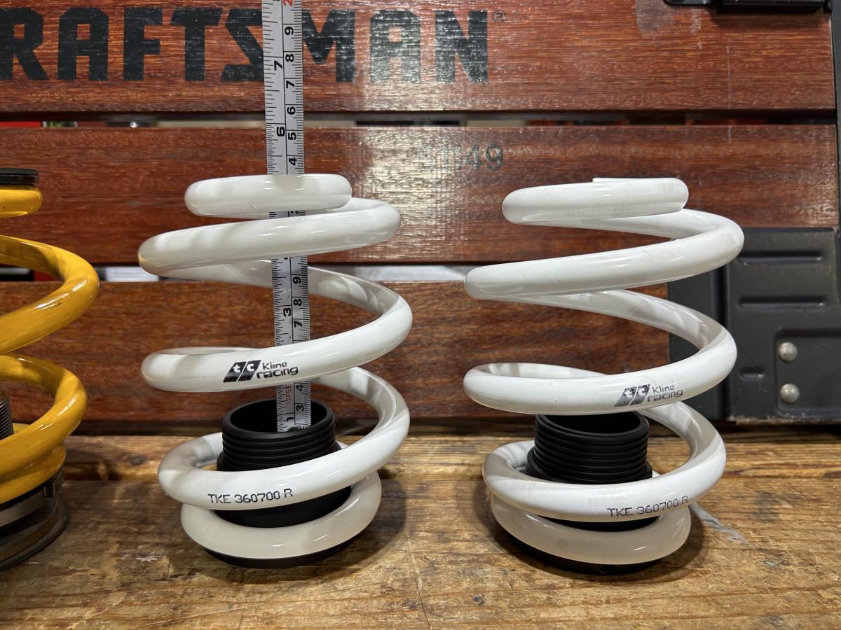

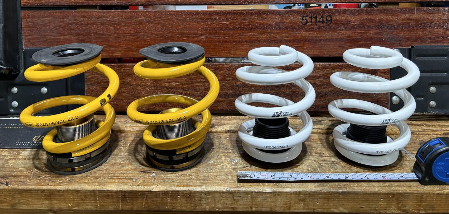

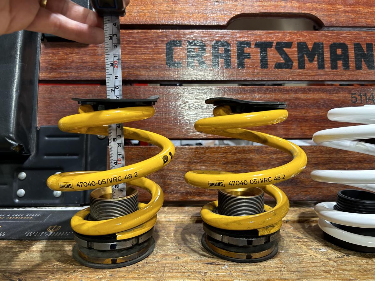

                Obioban I’m going to compare the Ohlins 628# rear to the TCK 700# rear paired with the Ohlins 400 fronts for on track duty with Intermediate drivers.
                This Ohlins 628# stack (as set by RRT) measures to 6.5” inches and results in a 13” ride height. The TCK 700 stack is different. When the perch is fully lowered on the threads of the TCK ride height adjuster, this spring g has a 6.5” stack at the highest point of the coil, note that coil is not wound as flat at the top as the Ohlins.

                  How long are each of those springs out of curiosity?
                    Do you want me to measure the length of the material?
                    if just simply the vertical dimension:
                    - Ohlins are both 5 1/8”
                    - TCK one is 6”, one is 6 1/8”
