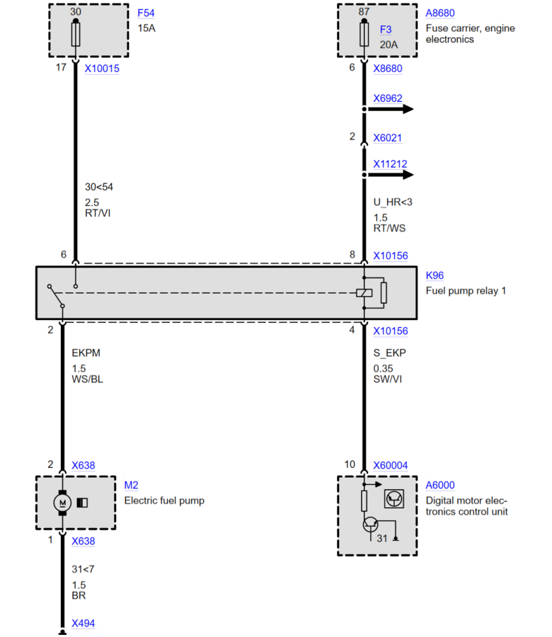

      Originally posted by Martyn View Post
      Low side (ground) switched from what I can see!
      This diagram shows a electromechanical relay. I believe all or some US cars have semiconductor relays and the control can be different.
        09/2003
        manual or SMG? pls next time provide these basic but needed information.
          This DME is for 2003/03+ and there is no fuel pump control on pin10 or pin11. It uses serial CAN bus.
          Edited: This seems to be not for USA cars.

              Sorry, didn't mean to throw you off with my euro wiring / assumptions.
                Martyn, that WD is correct. It shows the mechanical operation & not the solid state, but the supplied ground is pulsed (PWM) from the DME, based on the EKP duty cycle map. The actual pulse is 0 VDC > 5 VDC (㎲ hold) > 14.1 VDC. Obviously a duty cycle of 100% will be continuous 14 VDC.

                  Hopefully you don't need to deal with pin31 and 35 CAN bus wires. Don't ground those pins or wires!
                  It seems the DME commands another module via CAN bus to energize the pump relay. For now you should check the 8-pin relay: jumper from pin2 to pin6 should run the pump. If not then either bad pump or bad wire from pin2 to pump, or pump ground wire.

                        pump connector: pin1 is the Brown wire and it's grounded. You should check with meter.
                        Relay connector: pin6 is 12v via the Fuse 54. So it pin2 is not 12v then check voltage at fuse 54. Once you have pin6 with 12v then jumped it to pin2 should run the pump. Hope you have a meter; if not get one.
