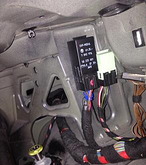

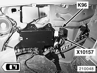

          Did you recheck the condition of the fuse after this incident? Doesn't cost anything to check. Does this happen to be F54 15A fuse, you can also check 20A fuse F3 located in the Fuse carrier Engine electronics. This too is no cost (unless you have to replace it.
          Additionally, there are 2 locations for the fuel pump relay. Coupe...right side trunk forward of the battery (black), Convertible...right side of passenger seat under the trim (black).
          It's not in the vicinity of the glove-box.
          Click image for larger version  Name:	relay-coupe.jpg Views:	0 Size:	155.4 KB ID:	92855 Click image for larger version  Name:	relay-convertible.png Views:	0 Size:	52.7 KB ID:	92856

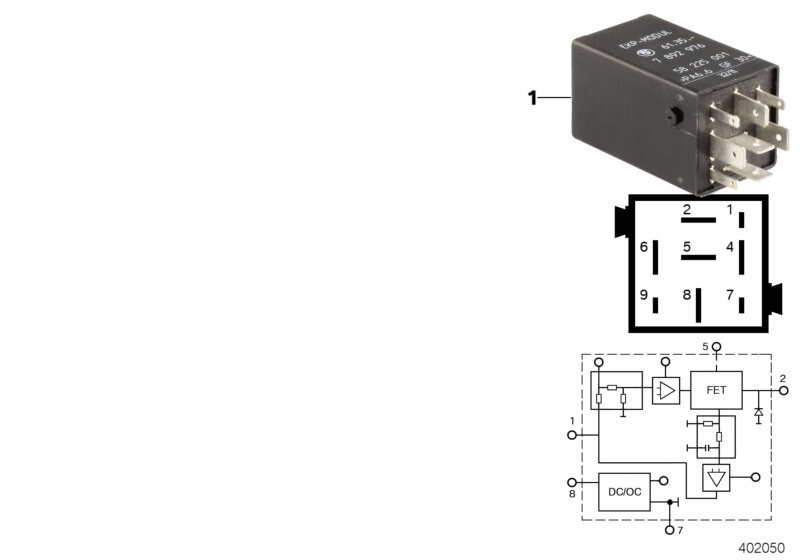

          You want to bridge 6 with either 2 or 5 and it will run the fuel pump...
            #35
            This can be confusing, as pin 2 is the output to the pump, not 6. I think the diagram is wrong with pin5 as pin6 should be the 12v supply. So bridge pin2 to pin6 (pin8 is 12v for many other components and could be overloaded by the running pump).

                        This is correct! That previous DME pinout was for MS45.1 ZHPs, I believe. OP, also be sure to note that pin 11 that goes to the EKP (fuel control module) is on connector X60002 and not X60004.
                        What's interesting is the EU M3s didn't have EKPs, and they used pin 10 on X60004 and the green relay for their fuel pumps. So if you have a Euro tune flashed to your car, you can use the green relay with no problems. This is what many people do with their S54-swaps so they don't have to mess with wiring for the fuel system (which I'll make a post about soon when I get around to it).
                        That said, the MSS54 with a US flash will run with the green relay, because pin 10 on X60004 is still active on all MSS54s regardless of continent, but your fuel system will hate you. Ask me how I know...
                        OP if you want to test your wiring, theoretically you can move pin 11 on X60002 to pin 10 on X60004 and you should get a functional fuel pump. You mentioned previously that you replaced the green fuel pump relay behind the glove box so I can imagine US M3s are wired with both and BMW moves one pin around on the DME harness to either use the EKP or use the green relay.

                            I'd like to correct myself here and say this works in my case because my S54 is in a non-M chassis. I don't think this will work in an M3 unless both the EKP socket (X10157 in the trunk) and the FPR socket (X10156 behind the glovebox) are powered and on almost identical circuits. The schematics in the Bentley manual don't really reflect this and it depicts the EKP as an alternative to the FPR, not used in conjunction with it - therefore I'd assume the FPR socket isn't wired up.
                            But there is a way to find out: someone with a US-spec M3 would have to look at the wires going to the FPR socket behind the glovebox. If there's a black/violet wire that goes to pin 4 of the relay and can be traced back to pin 10 on X60004 and pins 2, 6, and 8 have wires as well, then we can conclude that the FPR is wired like an EU M3/non-M E46s and is possibly used as a backup for the EKP in case it fails.
                            As a side note: I don't know why there would be both an FPR socket and EKP socket in the same car to begin with. The only obvious reason why BMW didn't prewire the FPR plug X10156 for the EKP in all of the 09/2001+ E46s and put the EKP behind the glove box is because they would have had to somehow disconnect either pin 1 or 4 of X10156 depending on what engine was stuffed into the car. From the looks of it, the EKP can plug into the X10156 connector and it just needs terminals for pins 1 (DME signal from pin 11 on X60002) and 7 (which is ground). I don't know... all this making my brain hurt. Maybe I just discovered a breakthrough in the process of swapping an S54 EKP into non-M E46s?

                            Good edit and good question, I was thinking the same thing! On both the FPR and the EKP, pin 2 will send switched power to the fuel pump. If you volunteer to be the guinea pig and look at the wiring behind your glovebox, you might even find that it's already wired in that way - who knows!
