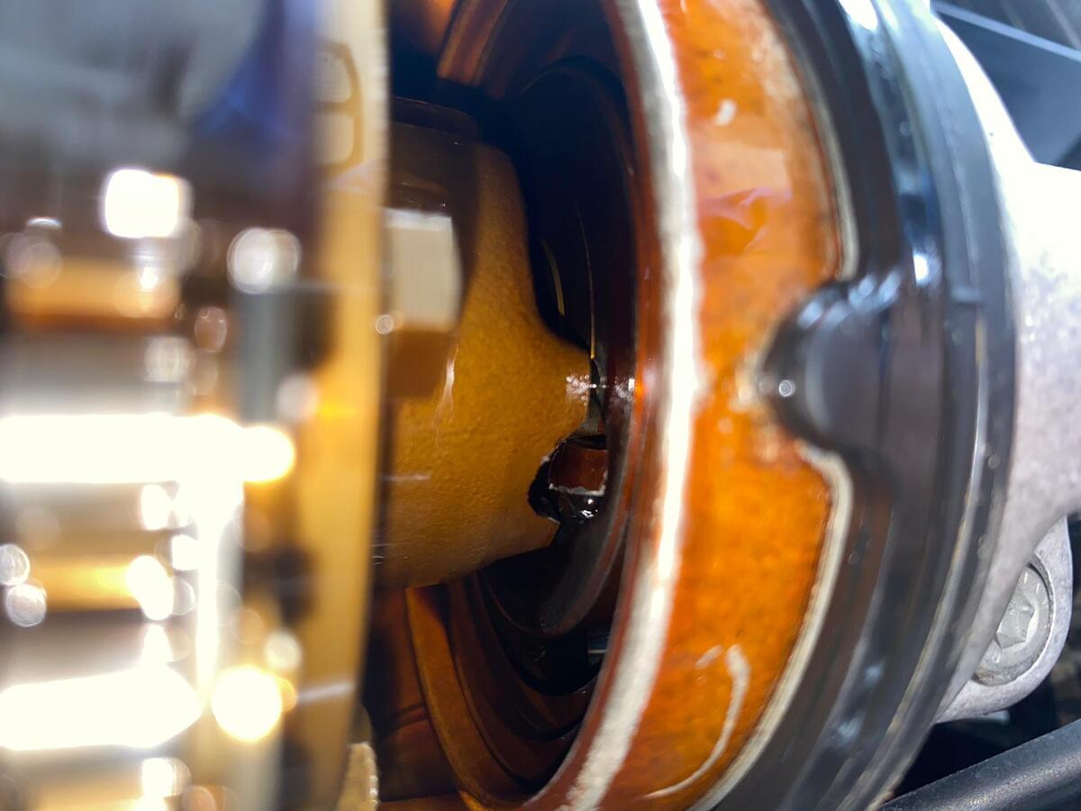

    I managed to take the valve cover off and I was checking the cam bolts and everything seems fine but I found another thing. Could this be the noise that I am having?Click image for larger version

      Not sure if this is the noise, it could be, but your hub broke a tab. Stop driving the car, time for a full vanos job. you’re one of the lucky ones that it got caught in the disk itself and didn’t fall into your engine.
      Beisan now sells an upgraded hub, which is what you should replace your broken hub with, alongside all of the beisan seals, solenoid, upgraded pump disk, and cam bolts.
      while you’re in there, you’ll have a good chance to inspect everything else, adjust the valves, etc.

          Jon, do not drive the car anymore. You need to get the full VANOS job done. Where are you located?

            Of you're around Orlando I can help you out. Definitely don't drive the car unless it's an absolute emergency. It looks like the piece already fell into the oil pan to me.

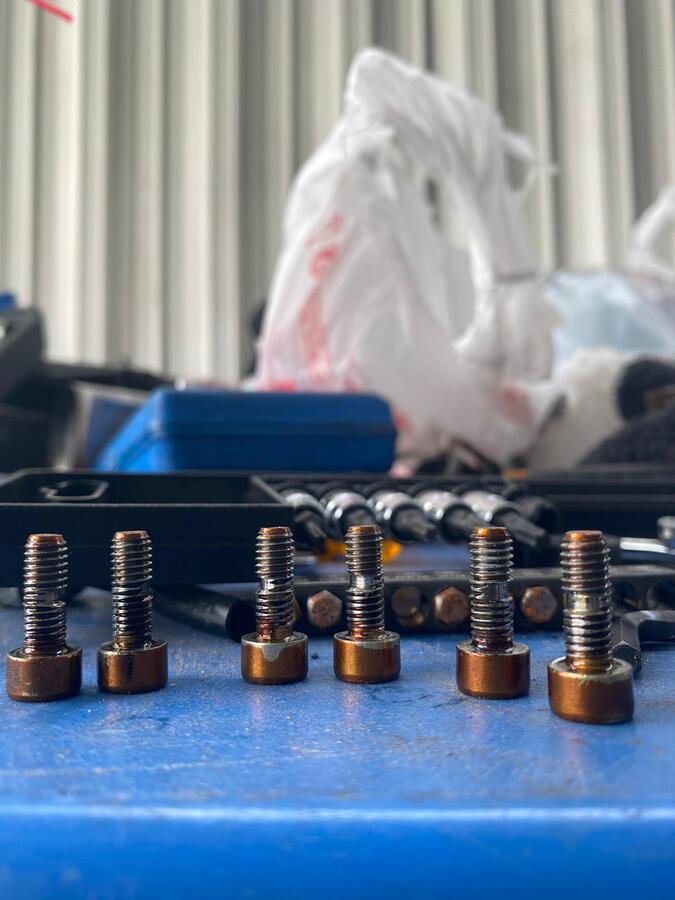

              Hi im back i finally rebuild the whole vanos car is running smooth thanks guys for the help
                woaaah those cam bolts are effed
                  What mileage is this?
                    That was getting dangerous! glad you got it sorted!
                      Nice work!
                        THOSE cam bolts I would not reuse (a little joke from a different thread ).
                        Glad you got it sorted.
