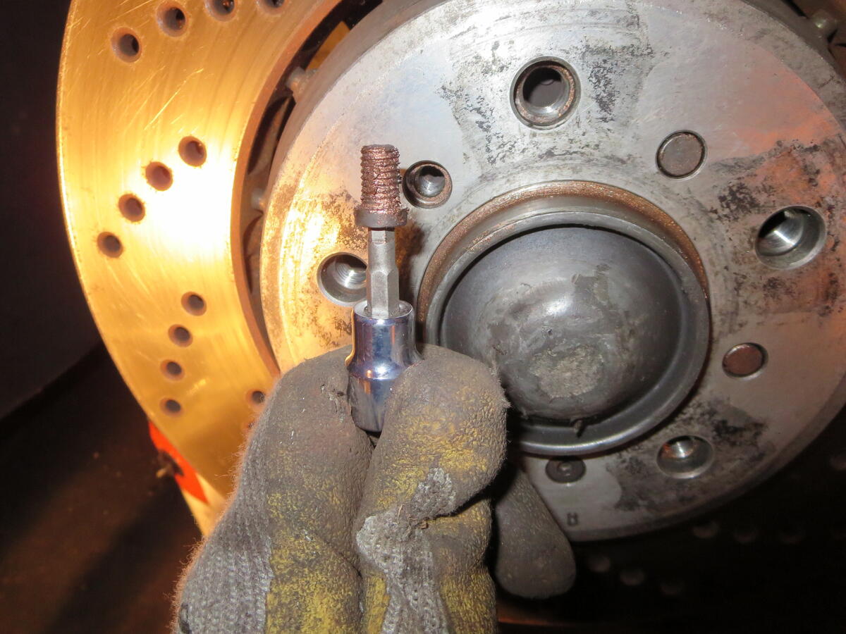

                    When you put the new rotor on, I'd recommend putting a small dab of anti-seize on the rotor retaining screw threads. I've seen too many instances where those get seized and you end up having to drill them out

                        Or just don’t install the retaining screw.
                        Anti seize on the hub lip is a good idea though to make wheel removal easier.
                          Anti-seize (used properly) is your friend!!!

                            Looking at this retaining screw, I wonder why the accounting guy allowed the engineer to have it. Maybe the lawyer said it was needed in case the wheel fell off the axle (Pep Boys fault) and the brake disk still worked and the company could not be sued.
