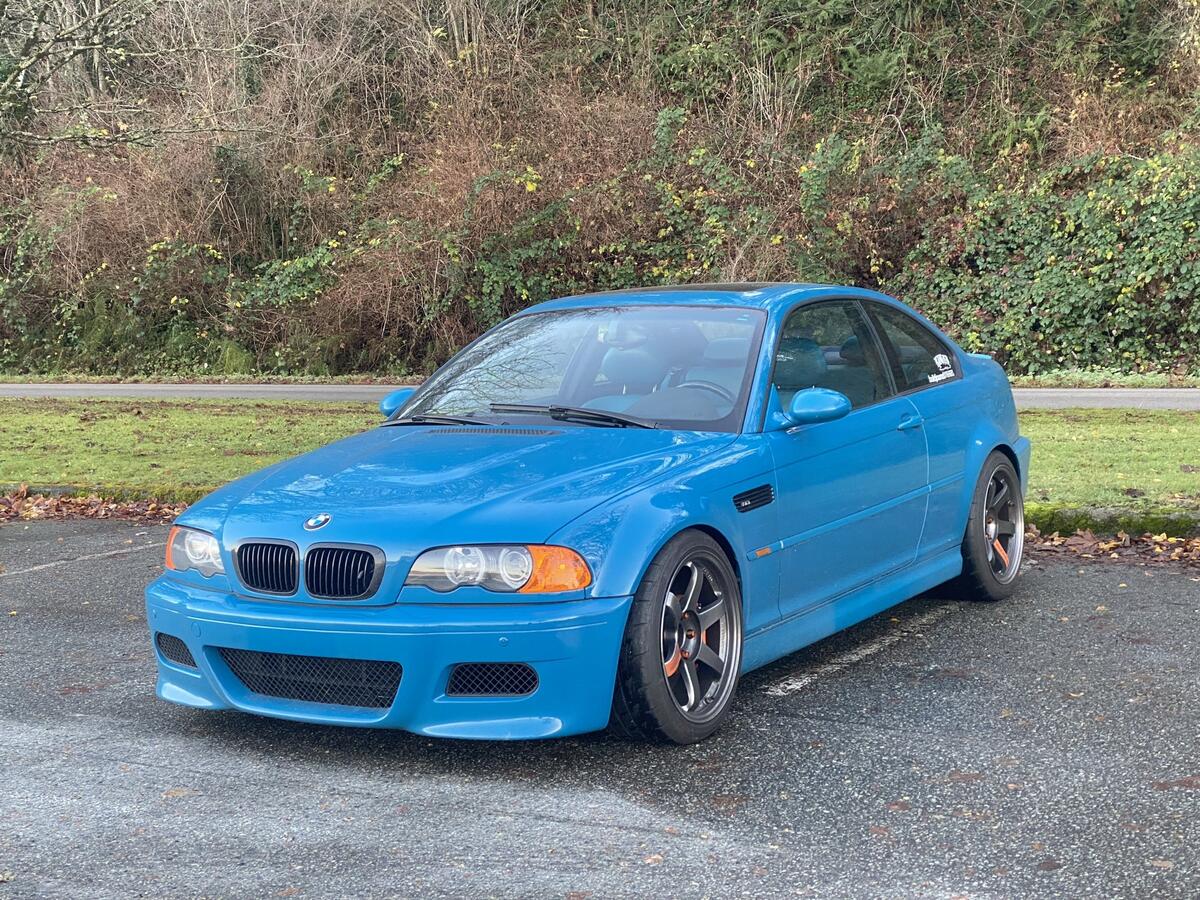

          This is what we did, same idea as above but with a little different execution.

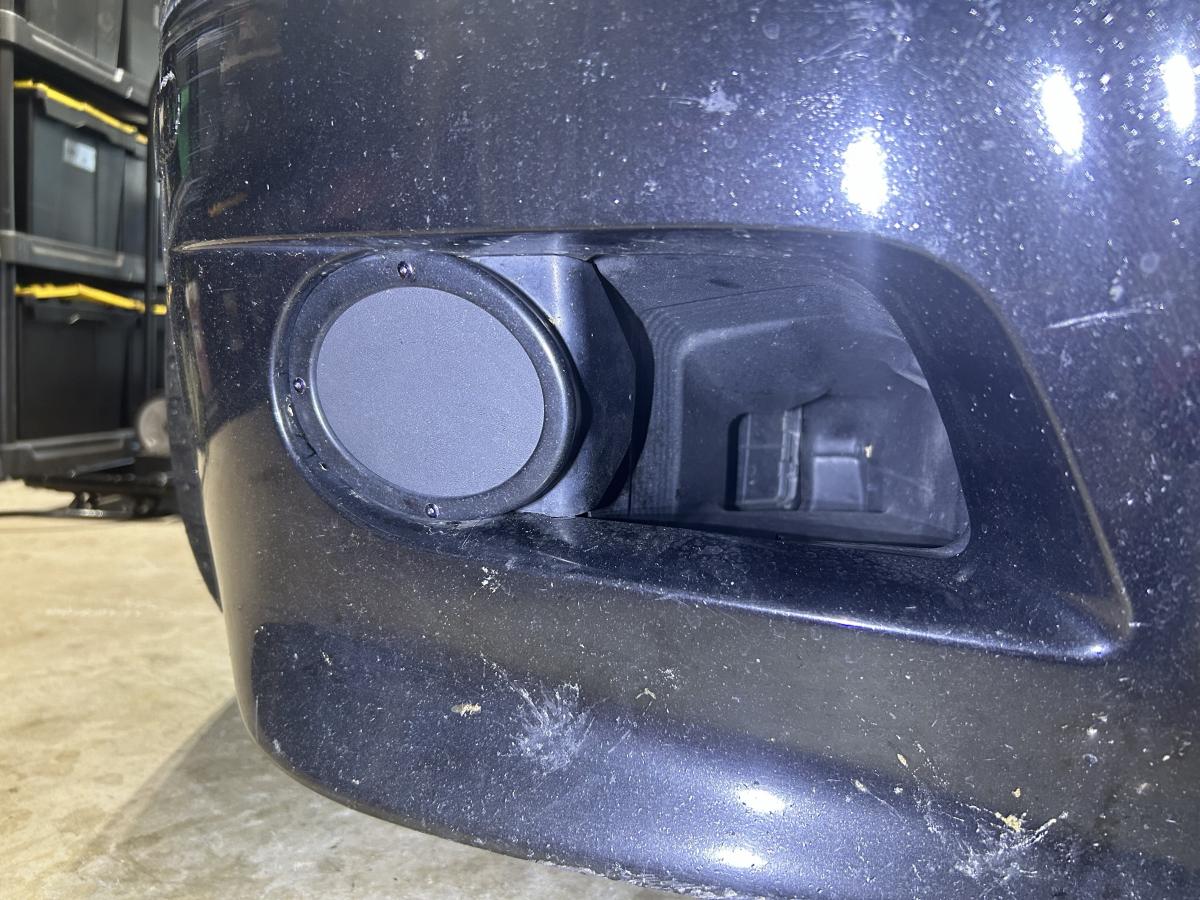

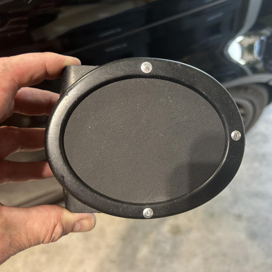

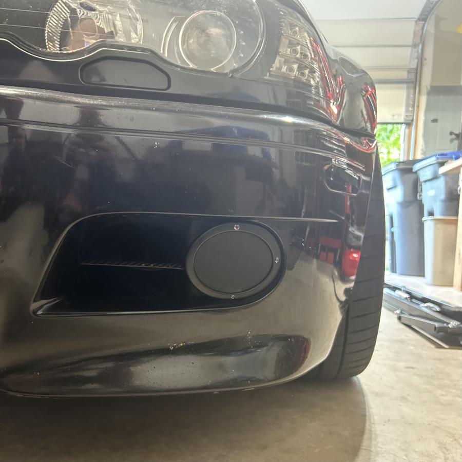

              Bad picture but I actually built foglight delete panels. Stock foglight trims with a plasti-molding plastic center. Painted black so everything looks uniform.

                  pawa_k2001, I really like what you did. How did you go about getting a plastic piece molded to fit in the stock foglight cover?
                    On our setup the car has a S85 swap and the oil filter housing is in the RF brake duct area, and the LF brake duct area contains the oil cooler. If you look closely the RH side is blocked off and the LH is open. We just backed up the mesh with a solid piece of black plastic and everything is secured with 3M windshield urethane.

                      $0. Stuff in my garage. The plastic is Kydex…I use it to make stuff for my other…umm…hobbies.

                          Mine cost me $0.
                          Find some black plastic in your home.
                          Acquire glue, the stronger the better.
                          Cut the black flat plastic to size and glue the shit outta it on the backside of the foglight trim.
                          Done.

                            Mine cost me $0.
                            I saw glue as a good option, definitely a cleaner appearance.
                            I chose the 1/8" rivets...maybe I just wanted to be done the job without waiting on glue. But, I justified using rivets because I can easily remove them and retrofit the light. I haven't determined why I might ever do that...maybe a cannonball. I was 10 when that movie came out.
