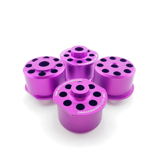

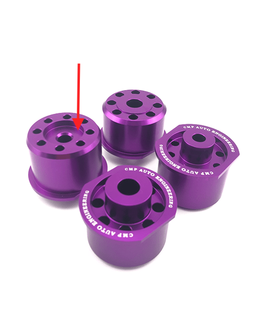

            For anyone who has installed solid subframe bushings, are the two front bushings supposed to contact the hex on the subframe mounting stud or the RACP sheet metal?
            CMP changed the design slightly to match other solid bushings which seem to contact just the hex portion of the subframe stud. The previous CMP bushings had a machined portion where the hex slotted in:
            Click image for larger version  Name:	xNclR65.png Views:	0 Size:	155.7 KB ID:	95477 Click image for larger version  Name:	E46SFRB-2-min_1200x1200.png Views:	0 Size:	245.4 KB ID:	95478
            Edit: CMP replied saying that both older and newer style bushings only contact the hex portion on the front subframe studs. The redesign helped with manufacturing costs and made the bushings 15% lighter in weight.

              When I made mine, rightly or wrongly I made them to touch both the hex spacer and the bodywork (reinforcement plate) so the bush had a recess in the top exactly the depth of the hex, thinking best to spread the load over the reinforcement plate and also the stud through to the upper reinforcing/brace.
                Very nice observation! It would be interesting to find out from CMP why the design change.

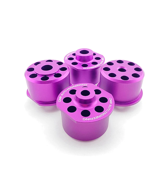

                  ^ If I read the CMP website correctly they redesigned their solid bushings to raise them.
                  If the car these bushings are fitted to has been lowered ~13mm, (1/2”) or more, you’ll find that the change in rear camber from both is equally opposite and you'll remain roughly in the same range of adjustment as before. To be clear, the need for adjustable camber arms when fitting these bushes only exists when the car is still at stock ride height.
                      One more thing I forgot to ask about the solid raising bushings (slightly raising the subframe), is there any concern with the driveshaft angle relative to the diff? Hopefully, that will not impact the service life of the driveshaft, CSB, diff or diff bushings.
                        Wouldn't raising the subframe put it back in the position it was from the factory?
                        If the reinforcement plates push the subframe down by the thickness of the plates, and the bushings raise it back up to correct for the plates...
                          Yeah, but the CMP document also stated something about correcting the suspension geometry for lowering the car.
                            Plates add material. Like if you added washers on top of the raised bushings. I don’t see how that would make it even out.
                            Diff carrier would be lower from the body and diff driveshaft geometry makes sense should be altered some.
                              Yeah, but wouldn't the plates add material in the opposite direction that the bushings would be raising the subframe? I don't think "raised" subframe bushings push the subframe farther down?
                                Raised refers to the subframe going up higher (closer to body), back to stock height even though you have plates.
                                Doing this puts you back in stock camber adjustment range (with stock chopsticks)
