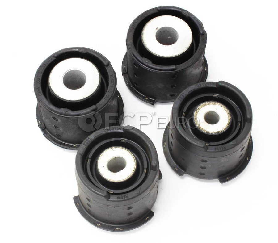

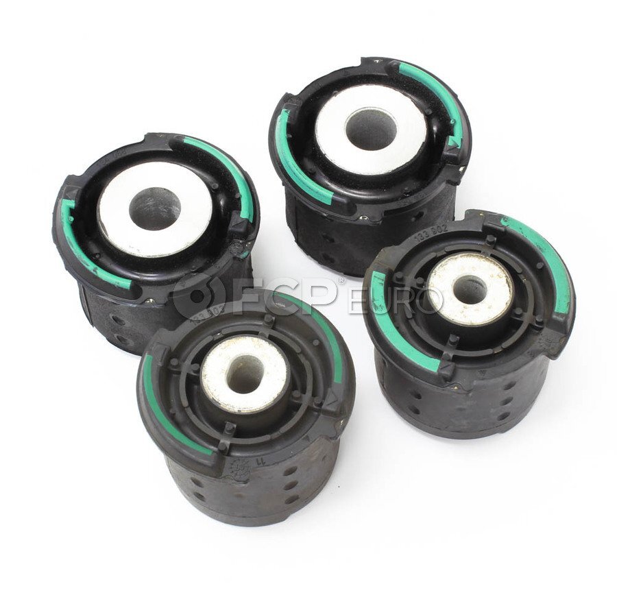

    Anyhow, question is are the current stock subframe bushings improved over the years. I noticed they look different on the bottom/top. Although it may just be a shipping protection/installation guide, the green area looks somewhat changed too.
    I’d like to upgrade on them, but everything out seems to be basic two-piece split replacements and nothing in a firmer stock design firmer durometer rubber.

      Thanks, yeah not sold on the solid or the Delrin versions quite yet. Not for street. I mean there’s a good deal of engineering that went into these factory mounts. The front two are different designs L and R from each other. Both are different from the rears. You can see the differences quickly. All these poly are the same mushroom design(mostly to hold in place), nothing engineered about their functioning really.
      And looking in the ETK all the factory M3 subframe bushings were revised in 3/06. So one could expect they’re even better. Unsure how many made it onto the late M3s or if they just had enough old stock.

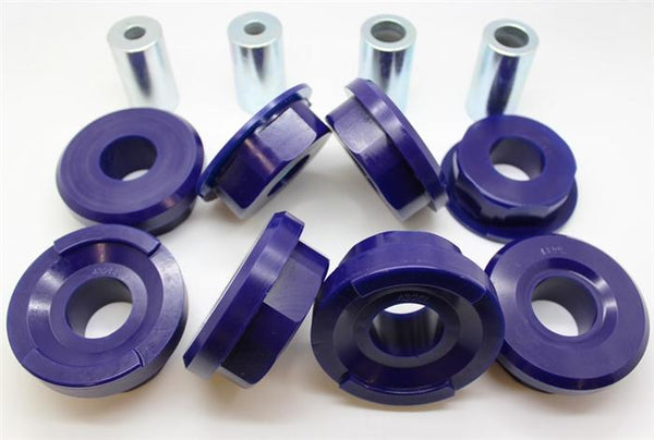

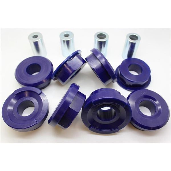

          Since you mention upgrades, I'll volunteer the option I went with a set made by SuperPro. Everyone is partial to the products they install of course. I'm happy and everything feels solid without added NVH, so that's why I mention. I don't know of any other members running them.

          Whether it’s an individual part solution, a kit of all the popular suspension bushes for your car or a complete assembly, SuperPro has an extensive range of complete bushing and suspension part kit

                  Just as fyi, those green tabs you see in the pic in the first post don't actually provide a "larger area" or "more stability" for the bushing. Especially in the front, where there is a large hex that the bushing inner sleeve (the silver metal part of the bushing) rests upon when everything is bolted up. That is why it is so important to do longer through bolts and cups in the front, because most of the forces are around the front studs. Also, most of the load of racp is on the 2 front mounts (see how the upper and lower control arm inner attachment points are super close to the front), so the 2 rear bushings act more as stabilizers in the compression/extension direction, but most of the critical articulation is around the 2 front mounts.
