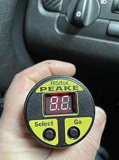

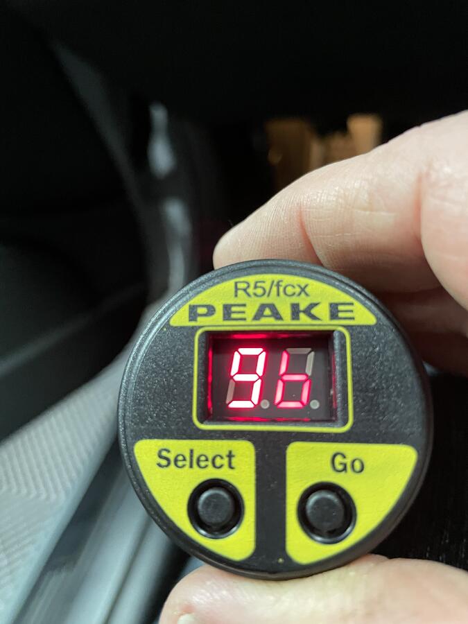

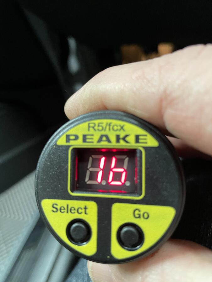

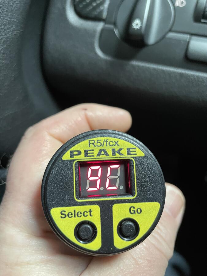

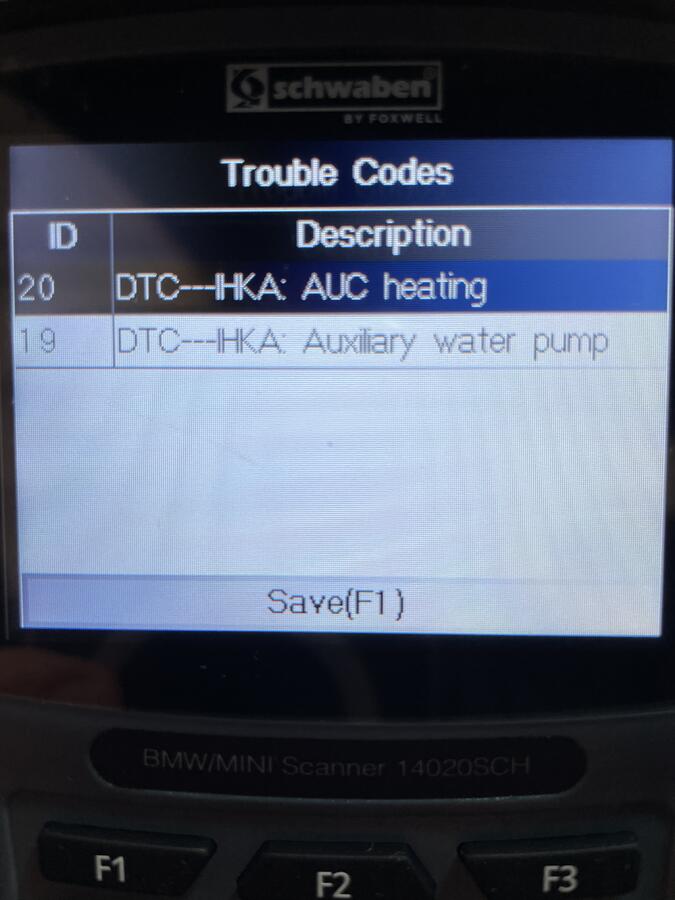

            So I just ran a code scan with both the schawben scan tool and a peake r5. Any help in deciphering these codes would be great.
            The r5 gave me the following faults,
            table 1b
            code 9b control unit self test, adaption EEPROM master
            code 9c control unit self test, adaption EEPROM slave

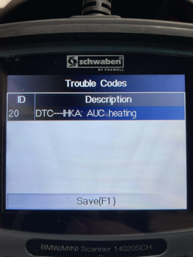

            the schwaben tool had this code

              So I continued investigating all the suggestions.
              -fuses are fine-
              I am getting two codes listed below, I think I need to replace the pump unit. Any other way to interpret these error codes?

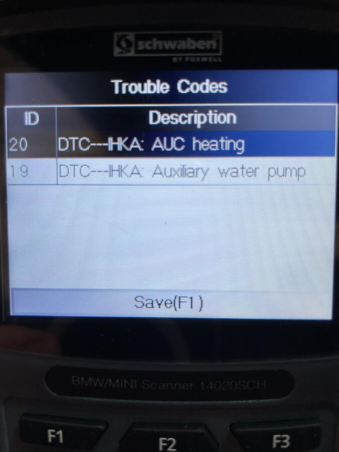

                Fuse was fine and the schwaben scan tool showed the fault codes below. Do you think this indicates replacement of the pump unit?

                    Thanks, do these fault codes confirm your hypothesis of replacement?

                              I’d have to search Swabben codes, don’t know those off hand. That Aux Pump could be a “currently present” or very likely a past code maybe if you unplugged it recently? I’d clear it and check again later. Water Valve and Aux Water Pump have different codes on systems I used.
