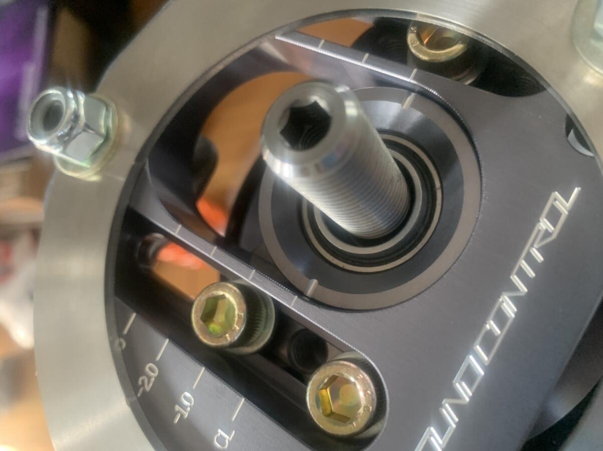

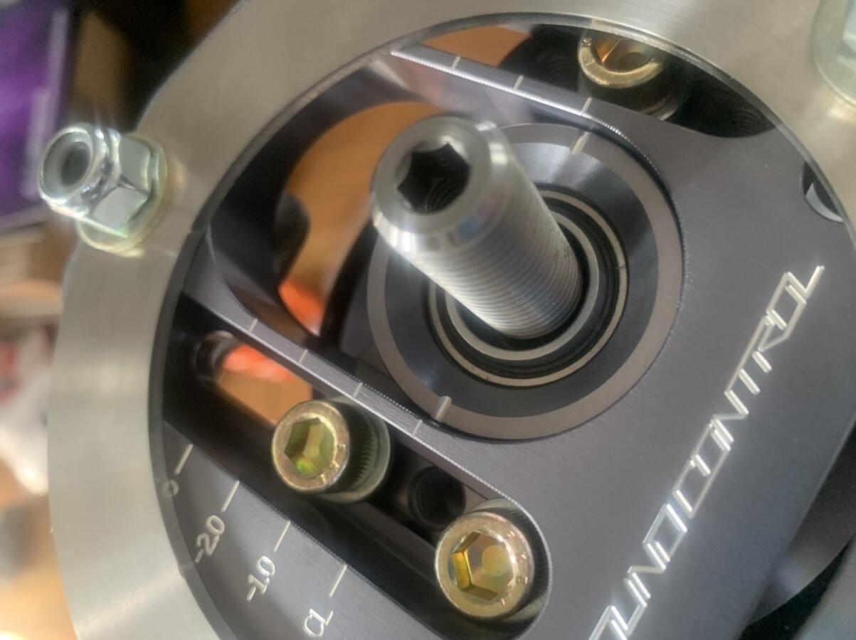

                            Sooo ... just spent a while on the phone with Barry at 3DM, turns out these GC hybrids aren’t going to work with the Ohlins kit. The bearing that’s supposed to fit over the strut pin sits mostly over threads instead because the plate is too thick. He said with the Vorschlags this is the case too but he makes a stepped insert for the top. To illustrate, test fitting without the spring:
                            So, since I want to install these damn things and get the car back on the road, I’m just going to reuse my oem top hats off the KWs with the stock Ohlins springs.
