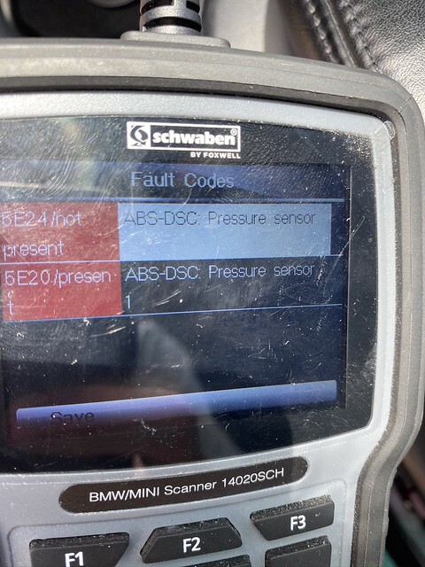

    Struggling with an intermittent problem with the DSC. Car is a 2004 SMG with the MK60 DSC unit. Took it out today and yesterday as the weather was nice. After driving for a while I get the DSC/Brake light come on usually as I am coming to a stop (just normal around town driving nothing crazy). I check the codes and I get:
    5E5D/not present - ABS-DSC Level Sensor Brake Fluid
    5E24/not present - ABS-DSC: Pressure Sensor
    5E21/not present - ABS-DSC: Pressure Sensor 2
    However I am able to log all these sensor values and they seem plausible values. Other than bad wiring any other issues that I should be looking at? Every time this has come up turning the car off and on again clears up the lights on the dash.

          Mate, you don't have any other codes other than pressure sensor codes, replace both pressure sensors, not the controller lol. Fixed my issue after replacing both sensors.
          Maybe you could get away with cleaning the connection to the the two pressure sensors first, but in my experience with the same fault codes, the pressure sensors needed to be replaced.

            If you were receiving every possible DSC related fault code you had a completely different problem to OP who is only receiving pressure sensor codes so it's best to replace the two sensors which the fault codes are pointing to, not the controller.

              Agreed. More likely this is the pressure sensors, which often do fail intermittently.

                Thank you! I thought i saw you post somewhere that you replaced both sensors and it didn’t fix the issue. I must have been mistaken.
                  My bad, I was too focused on the intermittent aspect of the issue and did not pay close enough attention to the fault details. I believe that the fifties kid has a video on changing these pressure sensors. Let us know how it goes
