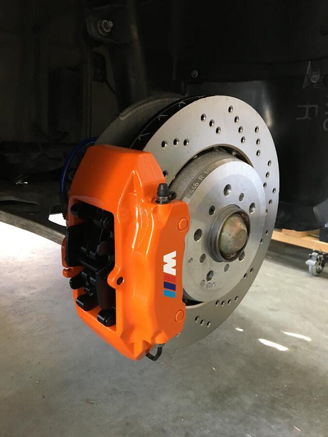

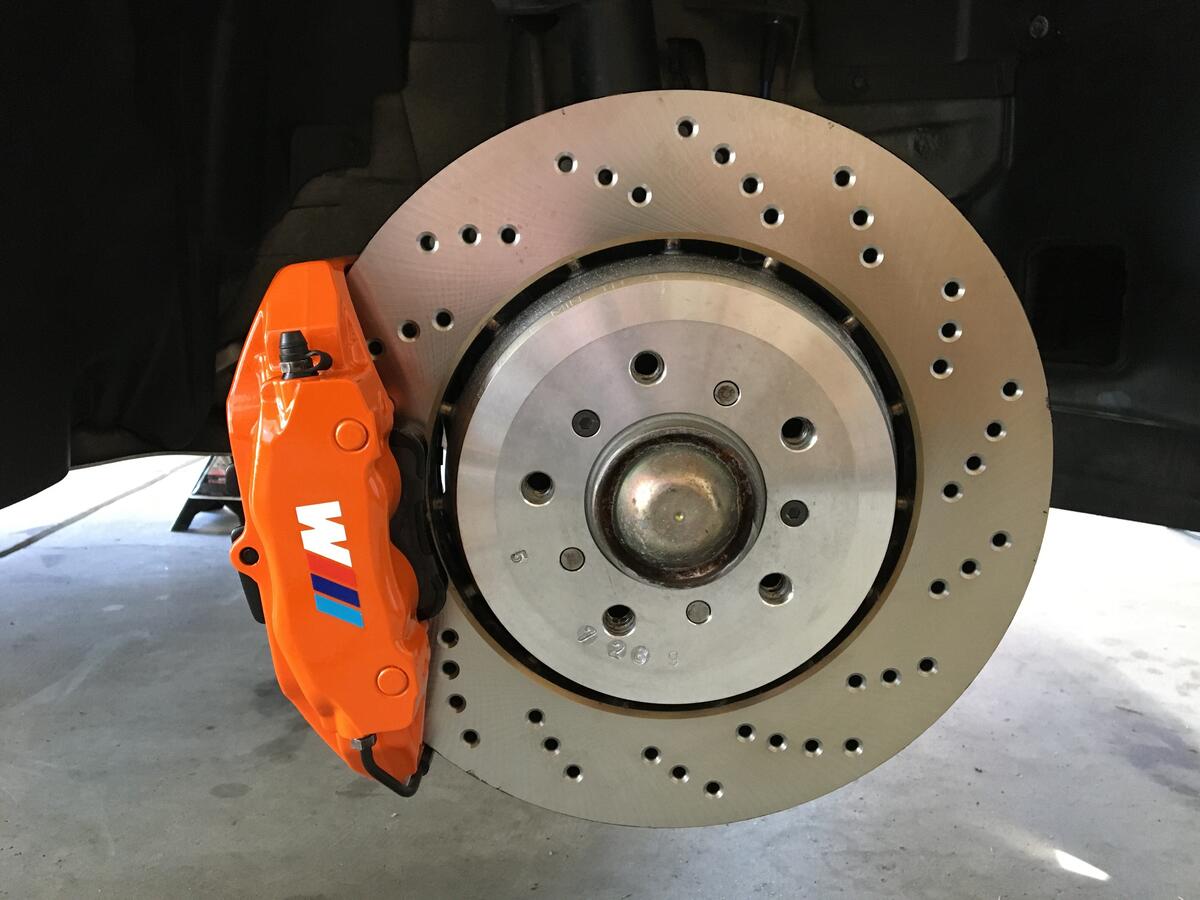

        I just got through doing a full brake job including a caliper swap from a 2005 911. I had the calipers powder coated but rebuilt them and installed everything else. I'd like to install a set of Titan T-S5 black wheels too to compliment the look I'm trying to achieve but the drivability takes priority over looks., hence part of the reason for lowering springs. Thanks guys...

              Came to say nice looking brakes
