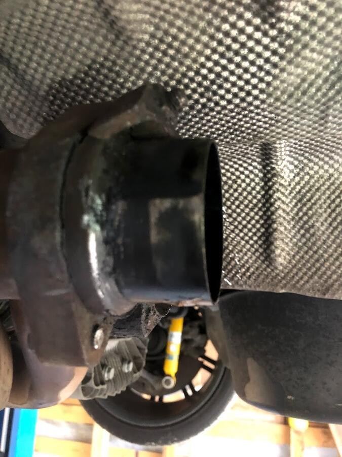

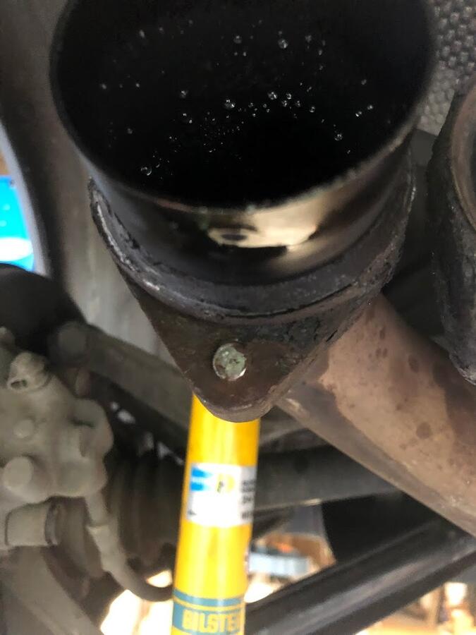

Hello everyone, my cats are rattling. That's why I took the spout off and disassembled it. I discovered this black stuff on the rear silencer.
Is that normal?

Oil?

Yes, Water and Oil

Looks like water / carbon. Did you start / stop your car before it was fully warmed up? If so, there's normally a good amount of water in the exhaust from the cat.

It stood in the hall for 2 days and I only put it on the lifting platform ...

Looks like wet carbon to me. Pretty normal. Carbon and water are byproducts of exhaust after it runs through a catalyst. I wouldn't worry.

okay thanks guys. You calmed me down ... I'll get some new kats and put it back together ...
