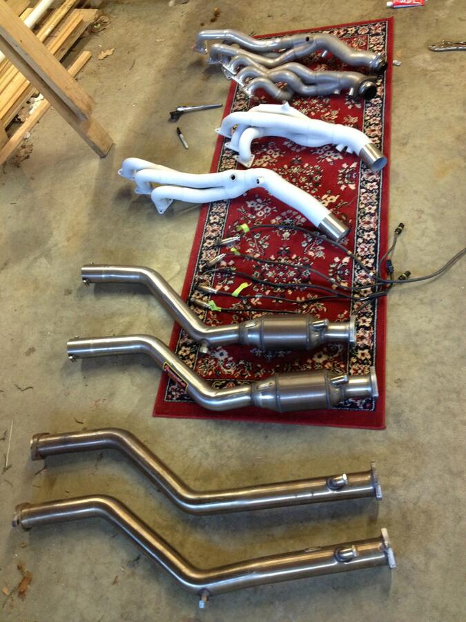

      From when I moved from V2s to V1s (V2s in Jet Hot ceramic, V1s in swaintech white lightning):
      Click image for larger version  Name:	IMG_2961.jpg Views:	0 Size:	104.2 KB ID:	99199

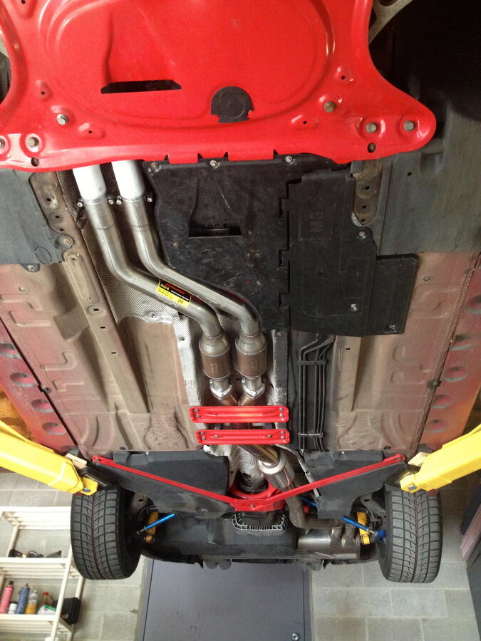

      Merge location with the V1s:
      Click image for larger version  Name:	IMG_2964.jpg Views:	0 Size:	94.7 KB ID:	99200
