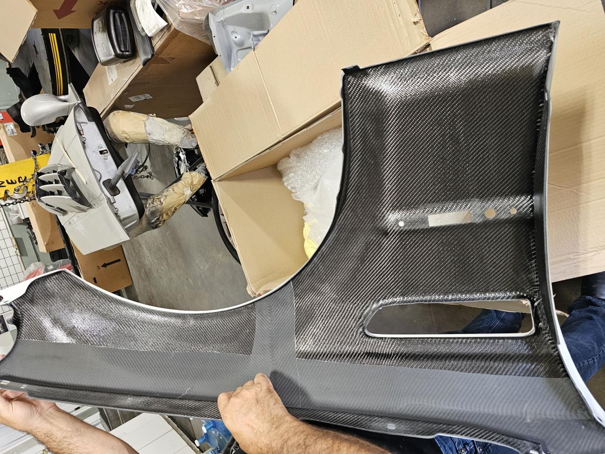

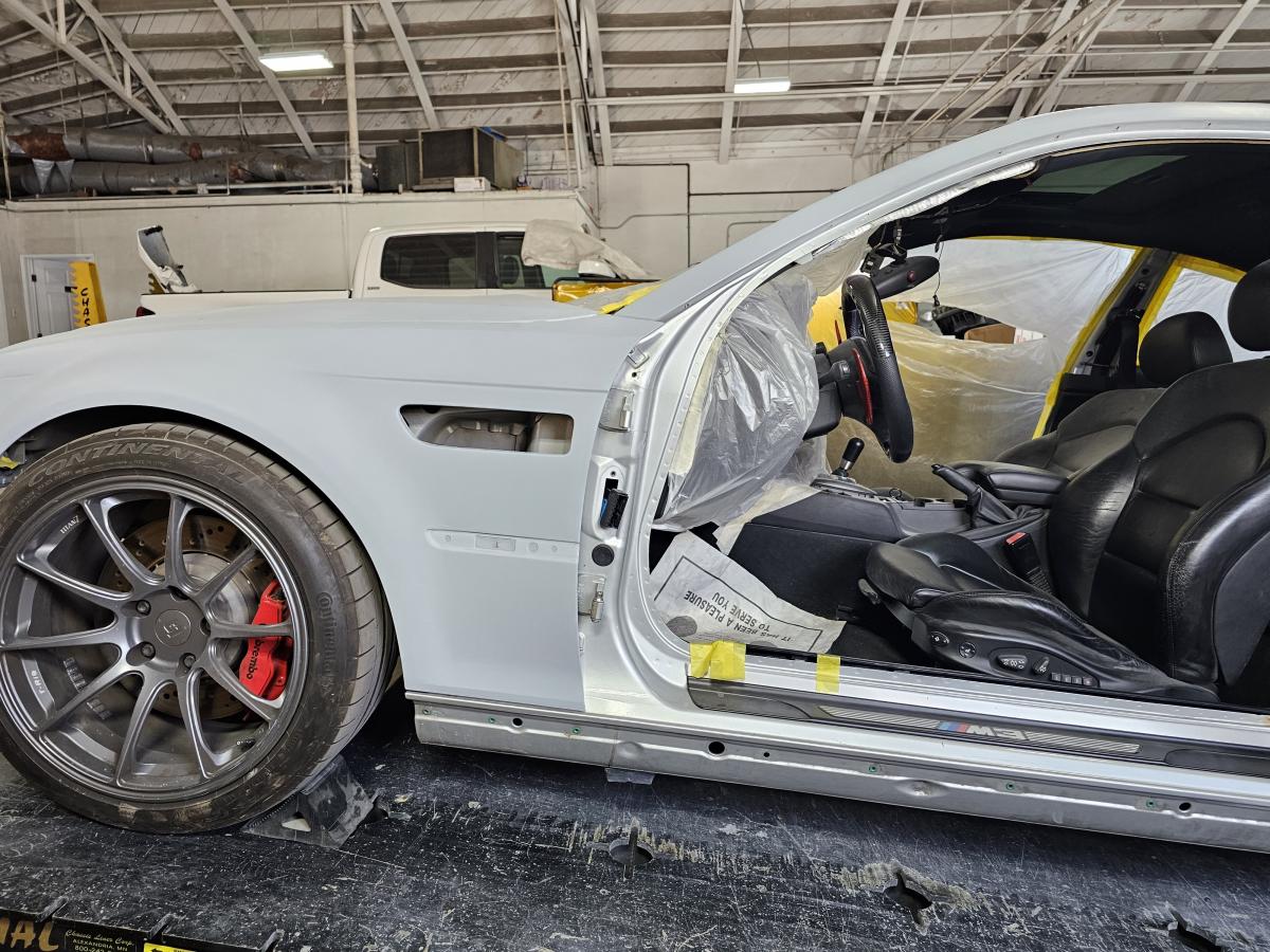

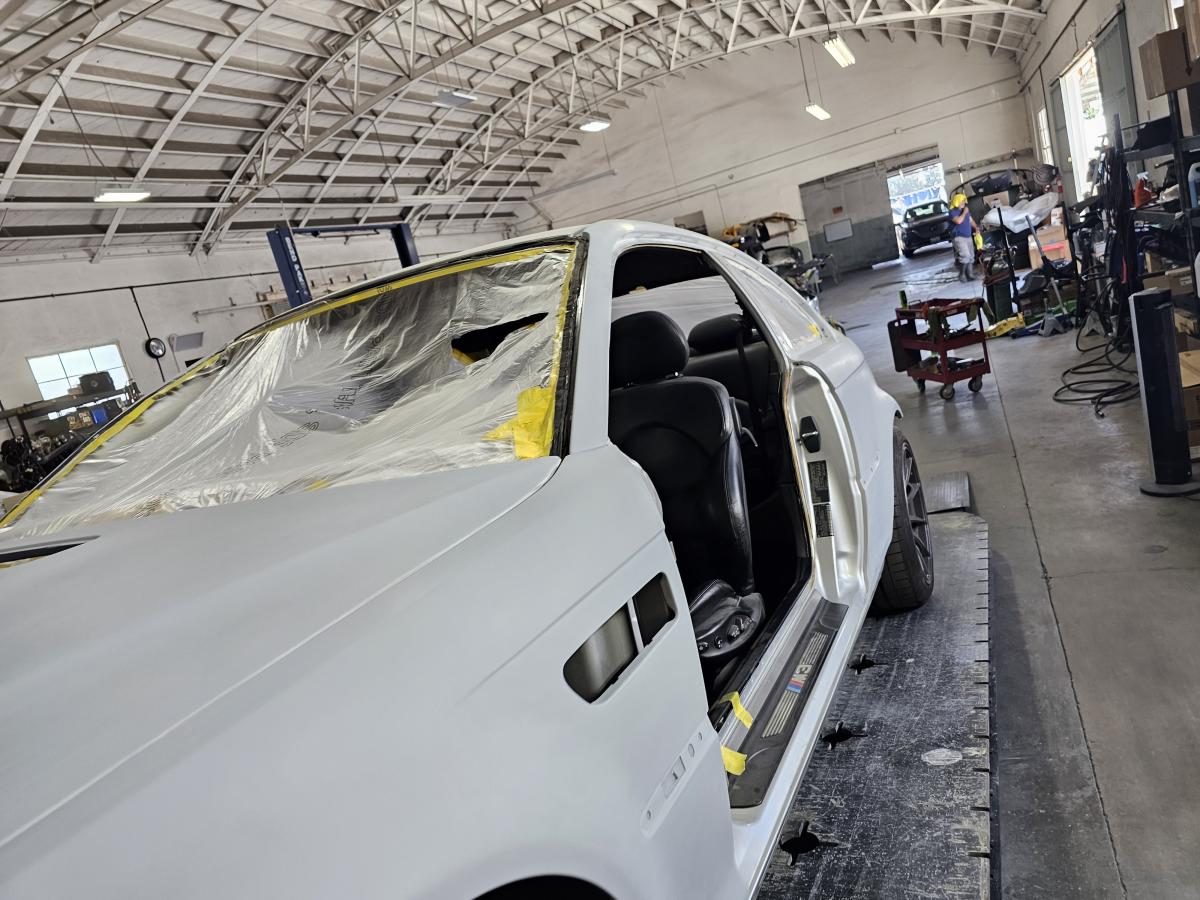

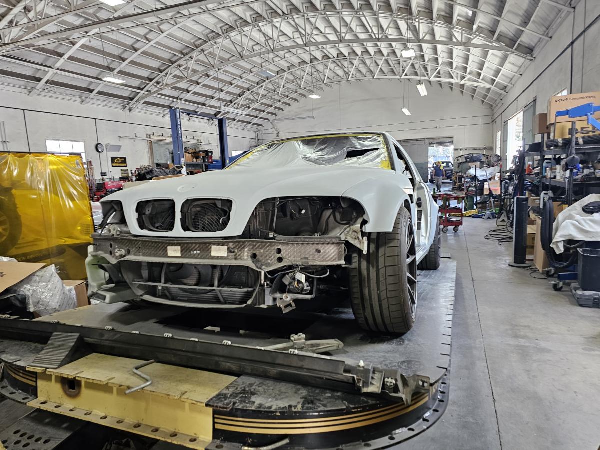

my car is currently at the body shop getting a full color change and some Karbonius + Alsetek CF goodies, Recaros, SS exhaust, etc.
*** updated my previous post***

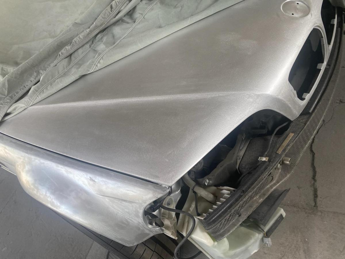

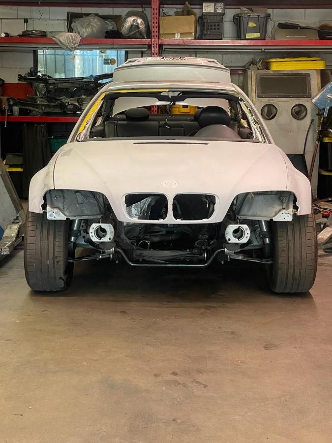

Engine bay and interior of car almost done with paint.
Decided to go it Voodoo blue paint code P7L
Decided to scrap the turbo plans and go for a big blower. Power goal is 750-800 whp without nitrous

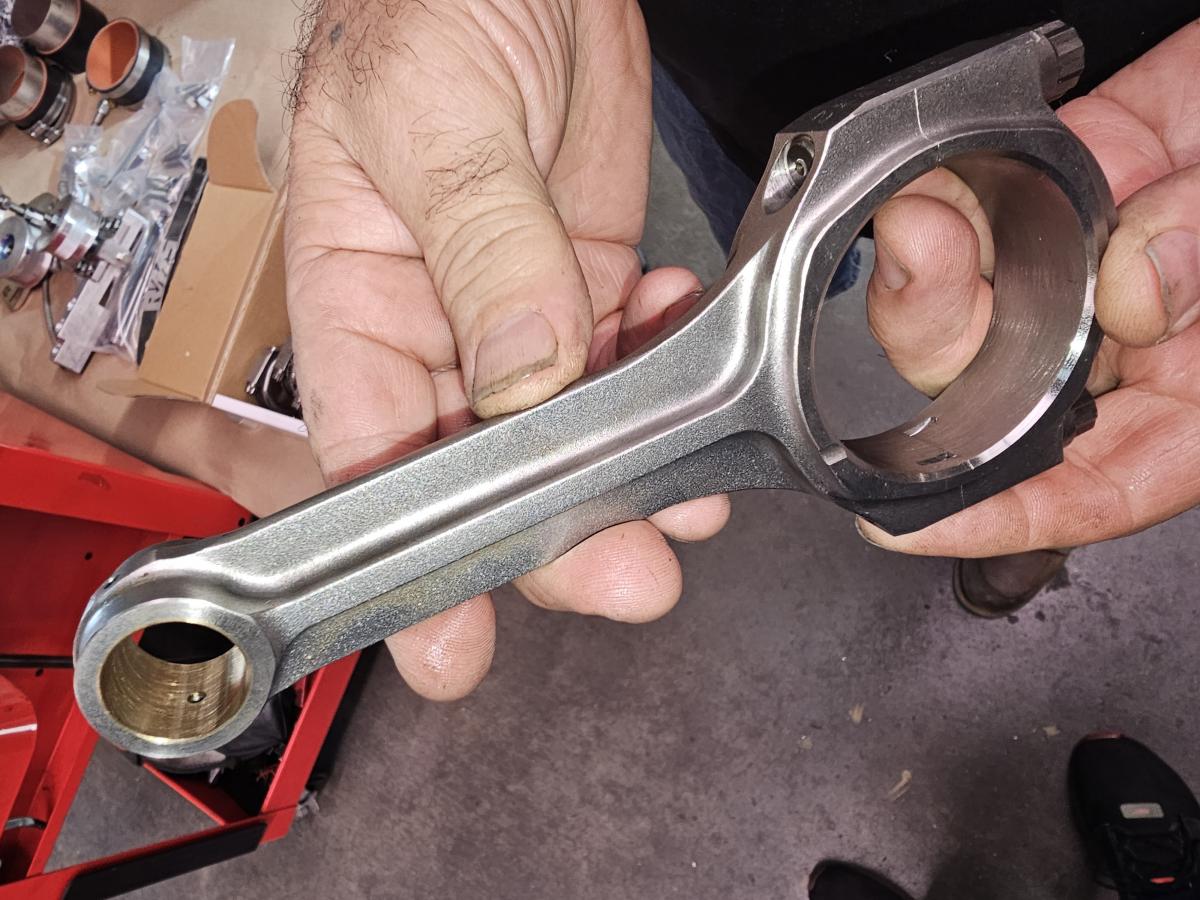

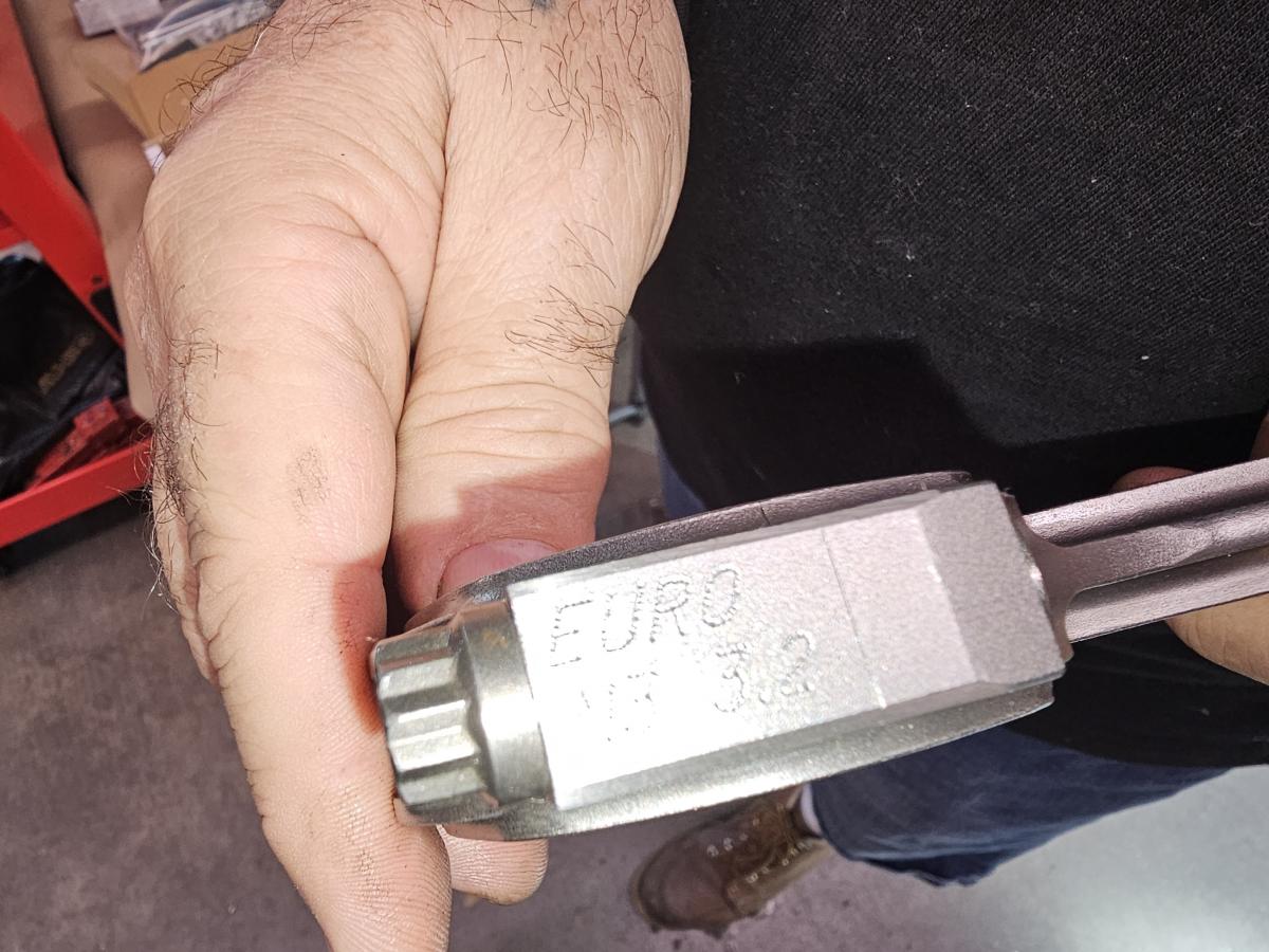

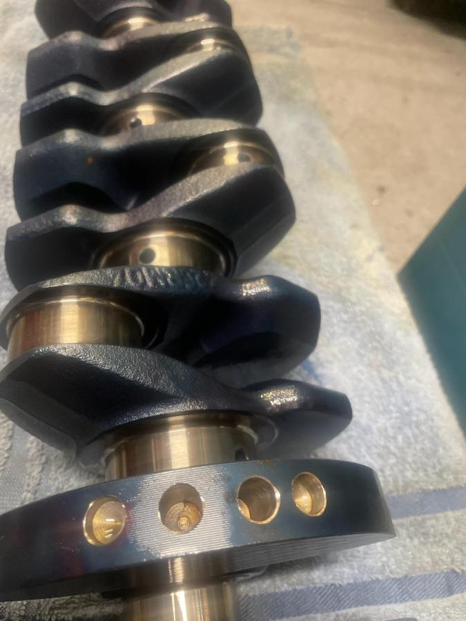

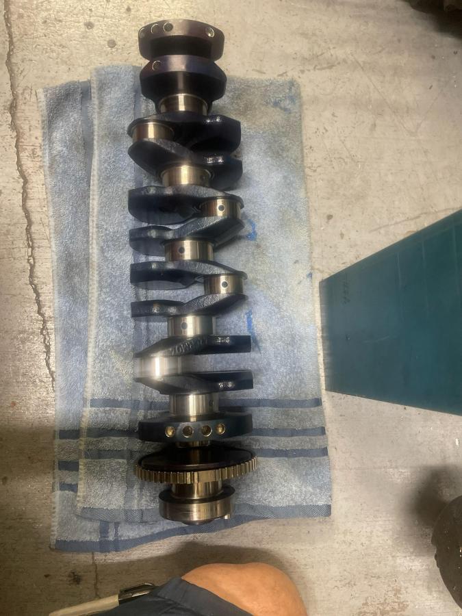

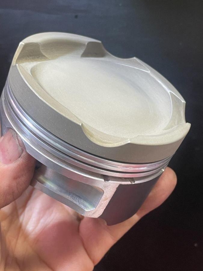

Engine is at RMS /OSHMO
- RMS /ROSS Racing 9.5:1 ceramic and moly coated pistons
- pauter rods
-s50 euro crank
-RMS aftercooler, tial BOV
-RMS oversized headers
-vortech V7 YSI-B supercharger with 10 rib belt
-Port and polish/ flowbench head +1 supertech exhaust valves, supertech intake valves, supertech dual springs with titanium retainers
-Schrick supercharger cams + dlc rockers
- nitrous express 6 cylinder port injection kit planning 225 shot
- I want to keep stock ecu but if needed will go stand alone
- fueling to be determined. Car will be running on e85.
maybe 2 Deatschwerks 420 or 2 walbro 450 + Radium fuel filter plus new lines AN8 or AN6 + will probably need 1200 cc or 1500cc injectors.
