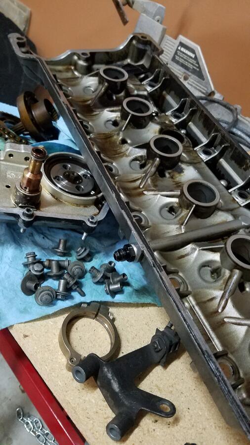

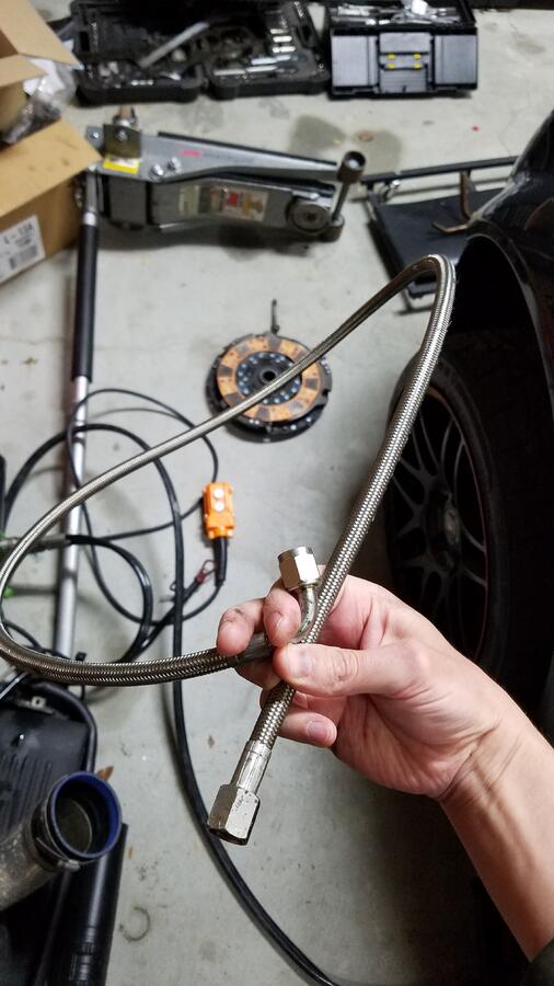

                            Yes sir I understand that. the SPA manifold would not fit onto the head with that line in place. I had to unbolt the line from the valve cover to get the manifold on the head but now obviously the line does not fit around the manifold while bolted to the head.
                            are you saying that you had 0 issues with that line and didnt have to move it at all and your SPA manifold bolted to your cylinder head fine with that line in place? If so then i guess i'm headed back to the drawing board lol
                              Ok I see what you're asking. I have a maximum psi kit that came with everything. There is a AN fitting and a long braided stainless steel line that I looped around the back of the head away from the manifold. Click image for larger version

                                wonderful looks like i have some more work to do then to adapt the valve cover line to an AN Steel braided setup but it answers my questions.
                                thanks for the help and info!
                                ill get to work on enlarging the SPA manifold holes as well for better fitment
