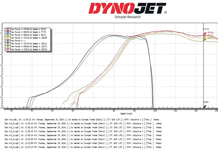

                        How does your curve look? Honestly I’m trying to avoid getting another precision(unless I get a deal on one). So BW may be the way for me. What AR you running?

                          Here is the dyno from last year. Unfortunately their rpm hookup wasnt working at the time and we couldn't figure out why it was dropping so much boost at redline. Turned out the intake manifold was cracked from front to back...

                            I want to give bw a try. Your graph doesn’t look bad at all. Maybe give the BB turbos they offer a try and see what they do. My precision is starting to leak oil too. Garbage turbo.
