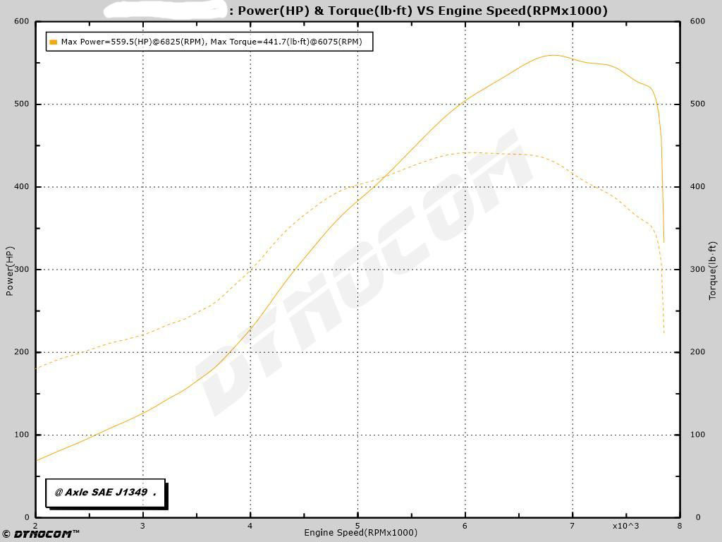

                                EDIT: Added dyno graph
                                running low boost on stock motor as its a daily driver right now
                                precision 6266 .81 a/r
                                doc race exhaust manifold
                                saad racing intake manifold
                                hpf 3" intercooler
                                hpf oil sump pump
                                saad racing pcv catch can
                                aem 3 port
                                tial 44mm wastegate
                                tial 50mm bov
                                fic 1000cc injectors
                                single walbro450
                                pro 128 piggyback
                                Click image for larger version  Name:	turbodyno.jpg Views:	0 Size:	83.9 KB ID:	52978​
